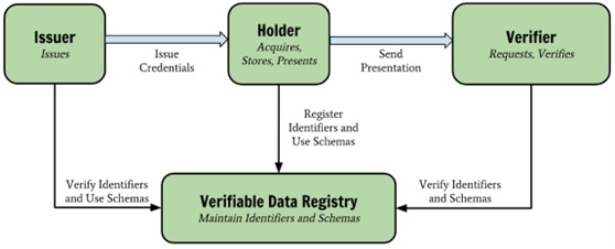

There are three different parties involved in the VC data model, which is presented by W3C (see Figure 1) [4]. These are the issuer, holder and verifier. A holder is a role an entity might perform by possessing one or more verifiable credentials and generating verifiable presentations from them. Examples of holders include students, employees and customers. An issuer is a role an entity performs by asserting claims about one or more subjects, creating a verifiable credential from these claims and transmitting the verifiable credential to a holder. Examples of issuers include corporations, nonprofit organizations, trade associations, governments and individuals. A verifier is a role an entity performs by receiving one or more verifiable credentials, optionally inside a verifiable presentation, for processing. Examples of verifiers include employers, security personnel, and websites.
Figure 1: An image showing different parties in the sharing of the verifiable credential and the underlying verifiable data registry that holds the public data, which is used as an anchor for the publicly trusted information. Courtesy: Industry IoT Consortium
A verifiable data registry is a role a system might perform by mediating the creation and verification of identifiers, keys and other relevant data, such as verifiable credential schemas, revocation information, issuer public keys and so on, which might be required to use verifiable credentials.

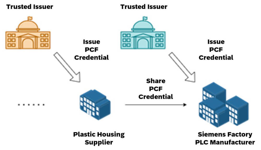

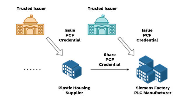

VC technology is core element of the TSX for PCF process. Once a manufacturer starts building a product for its customers, it is commonly built with products from other suppliers. Figure 2 shows an example product of a programmable logic controller (PLC), which requires among other things a plastic housing, which is sourced from one or more suppliers.
The list of all components describing the final product is referred to as the bill of materials (BoM). When the manufacturer calculates the PCF of its PLC, it iterates through the BoM, reaches out to the suppliers, and ask for the PCF of each component. The supplier receives the request to share the PCF of the sold component and reaches out to a trusted issuer within the TSX network. The issuer then takes the request for a VC for the product and validates that the process requirements are followed for calculating the PCF. It creates a VC for the product and cryptographically signs the VC so that its origin can be approved and shown that it indeed is coming from a trusted source within the TSX network.
After VC creation, the issuer sends the VC for the PCF to the requesting party. Upon receiving the VC, the supplier stores it in the digital wallet and therefore fulfills the customer’s request. According to our example and to Figure 2, this refers to the PCF of the PLCs plastic housing.
Upon receiving the VC for the PCF of the supplier, the manufacturer can verify that the trusted issuer signed the VC. Once the public key is retrieved from the data registry provided by hyperledger indy, it is used to determine the integrity of the VC and it is ascertained, if a trusted issuer in the TSX network in fact issues the VC.
This process of receiving and sharing the VC for PCF is repeated with all suppliers of PLC components listed in the BoM. This enables the manufacturer to calculate the PCF for all components. The manufacturer measures the energy consumption as well as the heating carbon footprint generated by the assets of its own shopfloor. All these carbon emissions are then aggregated to calculate the PCF. After completion, the manufacturer reaches out to a trusted issuer to get a VC for the PCF of the finished PLC, which it can share with customers.
Figure 2: The figure shows the process of sharing PCF credentials with a customer that uses a product in its manufacturing process. The VC for a PCF is issued by trusted issuing authorities that make sure that the PCF is being calculated according to the defined processes. Courtesy: Industry IoT Consortium (IIC)
