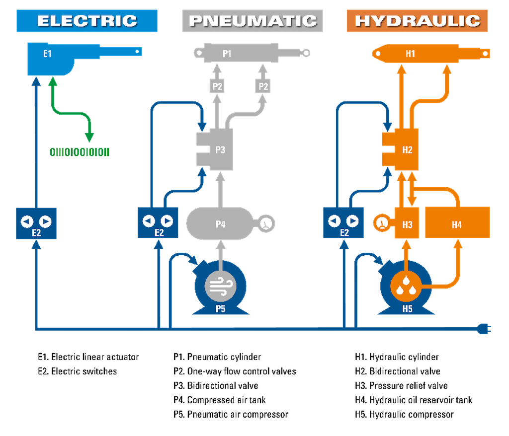

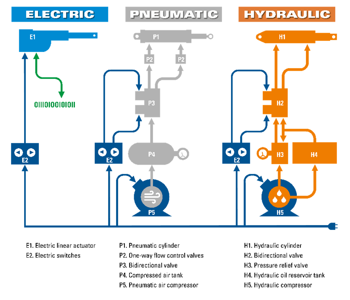

Electric actuators require fewer components than hydraulic or pneumatic systems (see Figure 1), reducing potential failure points and simplifying maintenance. On the other hand, fluid-driven systems require components such as pumps/compressors, hoses, filtration, valves, accumulators, breathers, oil, coolers/dehydrators and other infrastructure for monitoring and control. This complexity increases the potential for failure points. The simplicity of the electric actuator design lessens the chances of human error during assembly, operation or maintenance, enhancing overall safety and reliability.
Figure 1. When comparing electric actuators side by side with pneumatic and hydraulic systems, it is easy to understand how they experience far fewer maintenance and safety issues, including failures. Courtesy: Thomson Industries, Inc.

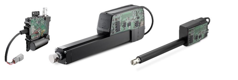

Electric actuators often come with built-in safety features like overload protection and emergency stop capabilities that can reduce the cost of ownership for equipment for most applications. They integrate sensors more easily and economically to monitor position, speed and load (see Figure 2). These sensors detect anomalies and trigger safety protocols if parameters exceed safe limits. Actuators also facilitate real-time adjustments that keep operations within safe boundaries and include fail-safe features such as spring returns or backup power systems. This ensures that the actuator will move to a safe position during a power loss or system failure. Programs can execute smooth start-and-stop routines, minimizing the risk of sudden movements that could endanger operators or machinery. Operators can program profiles to perform safety checks and initiate emergency shutdowns if necessary — all at a significantly reduced cost compared to fluid-driven systems.
Figure 2. Smart linear actuators are integrated with printed circuit boards (PCBs) to enhance controllability and contribute to worker safety programs. Courtesy: Thomson Industries, Inc.

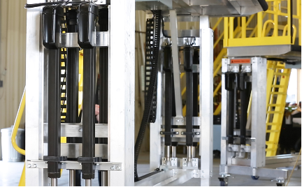

Electric actuators can handle many challenging environments and operate automatically with minimal human involvement (Figure 3). With the proliferation of onboard microcontrollers, features like proportional integral and derivative (PID) control at the local level can be achieved — reducing the complexity of the control system used at the plant or system level.
Figure 3. These electrical actuators use a synchronization feature to handle uneven load distribution and raise or lower the platforms smoothly and safely. Image courtesy of Thomson Industries, Inc.

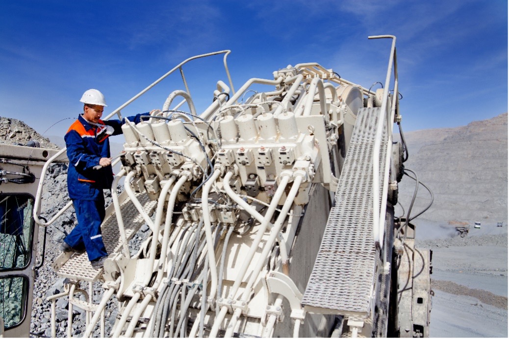

While fluid-powered systems may handle environmental challenges better than electric actuators, the frequent need for maintenance and manual control requires much more human presence (Figure 4). This benefit can be outweighed over time by the high cost of ownership.
Figure 4. With the complexity associated with fluid-powered systems, maintenance and safety require much more human involvement compared to electric actuators. Courtesy: Thomson Industries, Inc.
