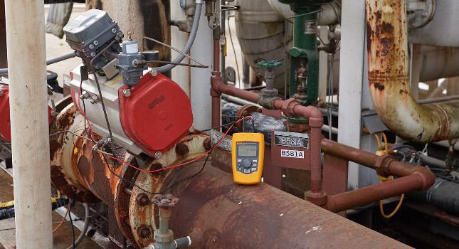

An automated loop calibration tool now available can quickly screen valves and separate the good ones from those that require more testing and should be pulled.
Using this handheld loop valve tester, it takes an average of only five minutes for a technician to assess the performance of a proportional smart valve (see Figure 1). Users can run several automated valve performance tests, including a signature test, speed test, step test, and bump/partial stroke test, all in less than half an hour. However, only one or two tests are typically required for screening, so even less time is required.
To set up the test tool, the technician removes control wires and connects the loop calibrator test leads to the valve. Once the tester is connected and HART communication is established, the technician can select the most common performance test, which is the signature test. The tool then ramps the signal from 4 to 20 mA and back to 4 mA. The tool automatically records the pressure applied to the final control element and the feedback from the valve’s position to determine the valve’s movement and position in response to that pressure. Ideally, a good valve exhibits smooth linear changes of pressure during both ascending and descending movement of the valve.
If the results show spikes, that means the valve is sticking. At the end of the roughly five-minute test, the backlit screen of the valve tester displays the results ─ good, marginal or bad. The full results are also recorded to memory and can be uploaded to application software for further review and sent to supervisors for help in determining whether the valve should be pulled.
