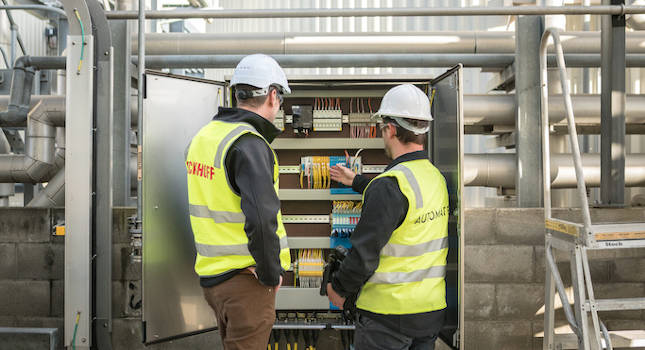

Figure 1: The PC-based control technology allows the straightforward integration of third-party software and hardware. Ben Haughey shows how Automate-X was able to integrate SCADA software and various drives into the automation system so easily. Courtesy: Beckhoff Automation

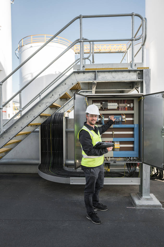

Figure 2: “On a single I/O platform, we can accommodate digital I/O modules, TwinSAFE, analog Ex inputs, NAMUR inputs, HARTs, and RS232/RS485 running on EtherCAT. Not only does the EtherCAT redundancy ensure a very high level of availability, but no other platform offers such flexible configuration options,” said Ben Haughey from Automate-X. Courtesy: Beckhoff Automation

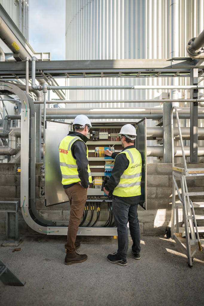

Figure 3: With the intrinsically safe ELX system, the signals can be acquired and processed directly from the hazardous area. By using fiber optic lines with cable redundancy, the extensive plant sections can be reliably automated and from long distances. Courtesy: Beckhoff Automation

It didn’t take long for Automate-X to decide in favor of Beckhoff — and PC-based control technology — because the open nature of the technology facilitates straightforward integration of third-party software and hardware (see Figure 1). This meant the Ignition supervisory control and data acquisition (SCADA) software platform could be incorporated into the tank farm project, and the tank farm operator’s existing drives were integrated into the automation system via EtherNet/IP.
Another key advantage for the project was the wide range of Beckhoff terminals, since the modular EtherCAT I/Os allow for the integration of safety, communication, redundancy and explosion protection components in a single system. “On a single I/O platform, we can accommodate digital I/O modules, TwinSAFE, analog Ex inputs, NAMUR inputs, HARTs and RS232/RS485 running on EtherCAT (see Figure 2). Not only does the EtherCAT redundancy ensure a high level of availability, but no other platform offers such flexible configuration options,” said Ben Haughey from Automate-X.

Intrinsically safe barriers are not required due to the use of ELX series EtherCAT terminals, which feature intrinsically safe interfaces (see Figure 3). This simplifies the electrical design and makes it possible to achieve signal acquisition in hazardous areas. The use of EtherCAT single-mode fiber-optic components enables communication between the tank farm operator’s extensive plant sections. In addition, the implementation of cable redundancy via a ring topology is possible via fiber optics to ensure a high level of plant uptime (see Figure 4).

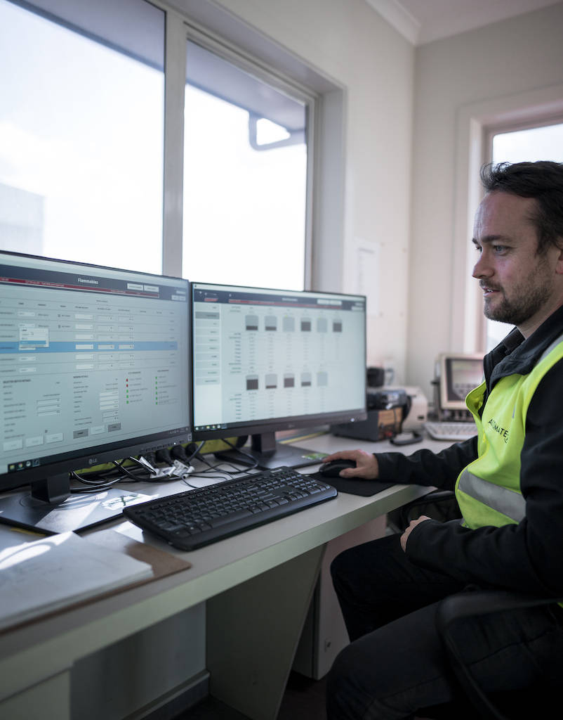

Communication between the various controllers and the Ignition SCADA system is implemented using OPC UA. Operators can access the SCADA system using intrinsically safe tablets, allowing them to access plant data and control the plant from anywhere onsite. Communication between TwinCAT and SCADA is seamless via the TwinCAT OPC UA standard.

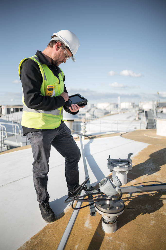

Figure 5: Automate-X’s Ben Haughey explains the features of the plant to Steve Rush from Beckhoff Automation. Due to the handling of explosive and environmentally hazardous substances, high demands are placed on the automation technology. Courtesy: Beckhoff Automation

“We are delighted that we have been able to implement an innovative and consistent automation concept for the tank farms using Beckhoff components specifically for hazardous areas,” van Niekerk said. [see Figure 5] “Our customer can benefit from a reliable solution that will stand the test of time.”
