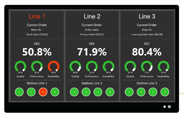

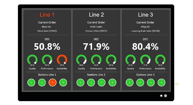

Original equipment effectiveness (OEE) is the product of availability, performance and quality. Knowing how to use these elements can help manufacturers improve operations.
Overall equipment effectiveness (OEE) is used to monitor productivity in operations. It also helps ensure the improvements we make in Kaizen events and other continuous improvement activities are real. OEE is about making sure a facility’s equipment is working as consistently and efficiently as possible, and that the flow of materials and people support this. Facilities that stay on top of OEE make sure their goods meet or exceed customers’ quality standards and are coming off their production lines at high speeds.
Many manufacturers don’t look at OEE as a key performance indicator. That’s a mistake, because our wastes, including the 6 big manufacturing losses of breakdowns, setup and adjustments, small stops, reduced speed, startup rejects and production rejects sap productivity and profit. They can be minimized if OEE is used effectively.
OEE is the product of three elements: Availability, performance and quality.
