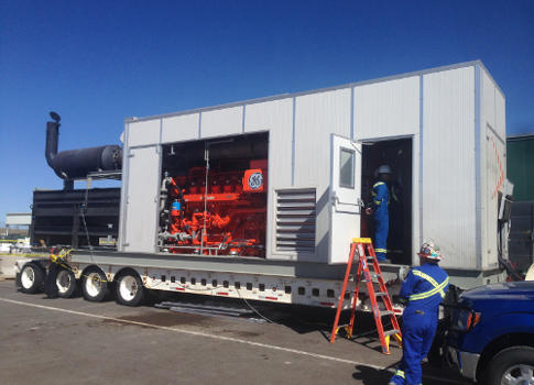

In a recent presentation at a Technology and Market Assessment Forum conducted by the Energy Solution Center, Aaron Trexler, Waukesha Senior Product Line Manager from GE Power discussed this alternative route. He noted the traditional approach for facilities that require standby power was diesel-fuel powered engine-generator sets. These are often sized between 500 kW and 3 MW. If properly maintained, they operate reliably for the relatively short hours needed in standby service.
However, Trexler noted, diesel units have their limitations. "They require on-site fuel storage for two or more days of operation, and that fuel has to be kept in good condition. Because of emission restrictions, unless they have significant upgrades for pollution control, they cannot be operated other than in emergency service.
Emission Restrictions on Non-Emergency Diesel
He explained that recent court decisions have confirmed emission restrictions for standby engines used on demand-response applications. "According to the U.S. Court of Appeals for the District of Columbia Circuit, beginning May 2, 2016, engines used for any demand response activity must meet emissions requirements for non-emergency engines. They must be fully compliant. Older engines are not grandfathered — they must be updated. Demand response with diesel just got more expensive, and fast-start natural gas units are a viable alternative."
Trexler suggests as an alternative that institutional and industrial owners should consider these natural gas-fired engine-generator sets such as the Jenbacher and Waukesha models offered by General Electric. "These units not only provide reliable standby power, but can also be used in a demand-response mode, reducing utility demand charges and providing economical site energy for 1,000 hours a year, or more. They are no longer a ‘stranded asset,’ but in effect become a profit center.
