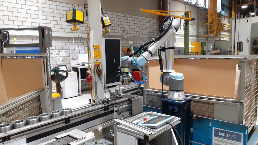

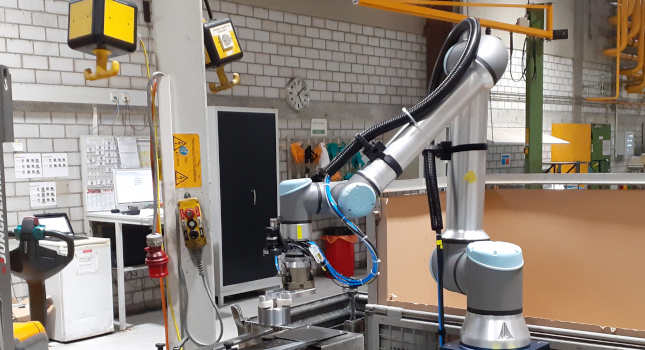

Automotive supplier automates workpiece pickup with AI control
German-based company ZF, an automotive supplier, was faced with the challenge of reconciling flexibility and precision when automating the workpiece feed of a large-volume milling station where gears are produced.

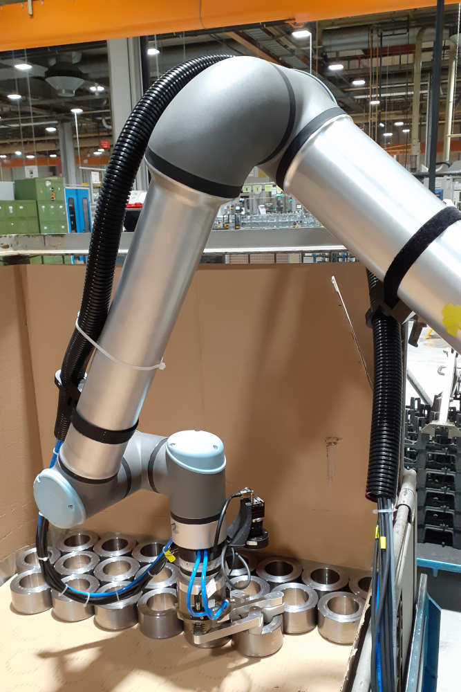

In the work process, metal rings are removed from a crate and placed on a conveyor belt to later flow into the production of the gears. Several factors made this process difficult to automate. First, the production step is variable, as the rings shift in the delivered mesh box and are randomly arranged. The placement and shape of the box also could vary. Changing light conditions posed an additional challenge, and the surface of the rings could be shiny metallic, sometimes oil-smeared, or even corroded, making classic automation impossible.
ZF used an AI controller and a collaborative robot (cobot) in an automated workpiece fixture. Using its own controller, the cobot positions itself over the rings in the crate. The system then takes control, moving the robot independently to the next ring to bring the gripper into the correct three-dimensional gripping position. The robot resumes control, picking up the ring and moving it to the conveyor belt for placement. The robot with added AI  setu took only a few days.
Figure 1: ZF, one of the world’s largest automotive suppliers, uses MIRAI AI controller and a collaborative robot from Universal Robots in an automated workpiece fixture. The complete setup of the robot took only a few days, solving a long-standing problem in a very short time. Courtesy: Micropsi Industries
