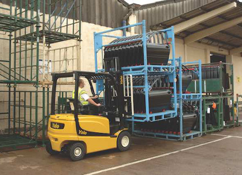

In an era of expanded digital networks, smarter connected devices and integrated systems, businesses are turning to data-driven intelligence to guide decisions to help improve efficiency and protect their bottom line. For operations with lift truck fleets, telemetry programs can produce a wealth of relevant small data insights for quick conversion into actionable business intelligence.
Even as materials handling operations face serious pressure to maximize output and efficiency, most facilities do not utilize fleet data to its full potential. A recent survey indicates that while 80% of companies track lift truck fleet data in some way, only 25% track equipment and utilization by specific drivers. The cost of not tracking this data can be high, especially since more than ever companies are focused on improving profitability, productivity and proper operator use.

An auto parts manufacturer began the fleet optimization process in order to reduce operating costs while maintaining flexibility to accommodate seasonal spikes and future growth. Based on current and future truck applications, labor resources and demand, facility staff identified fleet requirements and instituted a telemetry system from their local dealer to provide data-driven views into fleet utilization and productivity.
After gathering data for only a few months, facility staff identified areas with idle trucks, found opportunities to reduce fleet size through process improvements and identified specific order-selector models well-suited to picking processes.
By cutting excess trucks, instituting more efficient processes and adopting trucks tailored to distribution applications, the company reduced fleet size by 10% over the first year.
