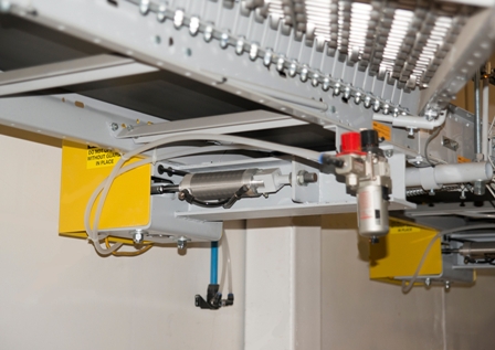

Optimize component sizes
It’s important to take the time upfront to correctly size the pneumatic system’s components because each component’s size affects other parts of the system. Buying smaller control valves may save money on the purchase price, but they will be more expensive over time. Smaller control valves will require the air compressor to work harder simply to get the proper pressure to the actuators, creating a long-term demand for more energy.
Another common problem comes from oversizing the cylinders more than necessary. Some oversizing is necessary to compensate for pressure fluctuations and air losses; however, components that are far too large account for one of the biggest energy losses in a pneumatics system.
For instance, a 3-in. cylinder requires more than double the volume of air of a 2-in. cylinder. However, this much extra capacity may not be needed. To avoid grossly oversizing, it’s important to remember most loads and speeds require only 25% additional capacity to ensure correct operation. By selecting the right amount of oversizing, cylinder efficiency can be improved by as much as 15%. When factoring in the number of cylinders that will operate thousands of times over their life span, the savings from right sizing becomes significant.
To assist with the many calculations and considerations that go into properly sizing components—such as if the load is rolled or lifted—there are software packages, online calculators, and even an iPhone app that can assist with component sizing. By spending a little more time understanding the system’s true requirements, the savings can be substantial (Figure 2).
