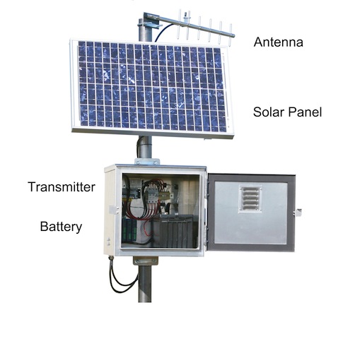

You can solve many problems by placing enhanced intelligence and local decision making at the end point, rather than calling for unbroken connectivity with the central controller. Autonomy at the sensor’s end is a great way to get around connection glitches and variations in bandwidth. Monitoring can be done in a “store and forward” scheme where the local sensor has the ability to store data and send/resend it as needed. That is becoming easier and easier to implement. Processors keep growing more powerful, yet their power requirements keep dropping. Sensors can now be equipped with powerful internal processors as well as significant quantities of internal memory. That’s a great substitute for perfect uptime.
One good example would be the U.S. Geological Survey mentioned earlier. The USGS monitors well and surface water conditions at sites all over the country and uses the data to make ongoing updates to its website. As you might expect, many of its sensors are deployed in very remote locations, and in places where there is no access to the power grid and no Internet infrastructure. Data communications are handled by low-power radio transmitters. Because the transmitters have low power but must broadcast across large distances and overcome interference, there will be ongoing fluctuations in bandwidth and link quality.
Trying to achieve 100% uptime in such circumstances would be absurd. Instead, the sensors use localized intelligence to record and store data, and they send/resend until they are satisfied that the information has been passed along.
