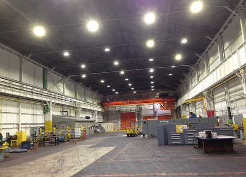

Industrial environments pose lighting challenges that aren’t seen in traditional office or corporate environments: hard-to-reach ceilings; large, open spaces; extreme temperatures; and nontraditional operating hours, to name just a few. As LEDs have become more prolific, and less expensive, they’re being used more and more in plant operations.
It can be tempting to cut corners or rush an LED lighting upgrade when you have several other irons in the fire. But hurrying through the process without fully understanding all the decisions that need to be made can leave you with a system that’s less than satisfactory. Avoid these seven common mistakes when upgrading to LEDs.

7. Forgetting about areas beyond the plant floor
The lighting used in your plant’s parking lots, conference rooms and front-office areas is just as important as the lighting used in your plant environment itself. These areas are often overlooked in plant operations, but the lighting in these spaces can impact overall safety, comfort and productivity as well.
