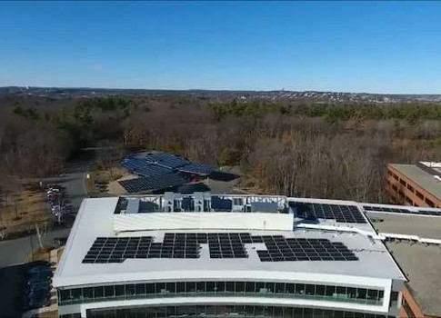

One of the most exciting trends in microgrids is mixing the old with the new. Microgrids allow for seamless modernization of aging electrical infrastructure, upgrading a facility’s legacy electrical system to optimize energy use, without needing to "rip and replace" the existing infrastructure. With microgrids, systems can be implemented to minimize downtime, lower costs, and increase sustainability all in a single project. Energy storage increasingly complements the new distributed resources and doubles as further power system backup for added resiliency.
While battery energy storage systems alone work as an excellent anchor resource, battery systems are still relatively expensive unless they can serve multiple use cases. Where electric power and natural gas are expensive, batteries and solar work well financially. Centralized power is 30% to 40% efficient at the point of use, and cogeneration plants often have a 55% to 80% combined efficiency at the point of use. Through microgrids, manufacturers can leverage cleaner and more efficient resources all while using less grid infrastructure and helping these disparate cogeneration resources work in harmony.
Renewables also can be used as a less expensive form of generation as they help establish applications of virtual power plants. These applications innovate by combining variable wind and solar with dynamic load management and storage to present a flatter load curve from the utilities point of view. And storage must be thought of as not just batteries, but thermal inertia and flexibility in loads and processes.
Flexibility in microgrid design is of increasing importance because many plants are in off-grid areas of the world—most notably in fields such as energy production, distilleries, or mining—and it’s just as pivotal for those facilities to remain functional and cost effective as on-grid enterprises. For many plant managers in remote locations, using renewable energy via a solar-assisted microgrids is more cost-effective than transporting other fuel and establishing new distribution and transmission infrastructure.
New, advanced microgrids couple solar photovoltaic (PV) with other distributed energy resources as an anchor resource to island—or separate—from the grid and enhance resiliency, helping to power campuses and small communities independent of the grid during an outage. In addition to the economic benefits, microgrids also contribute to the sustainability of a corporation.
