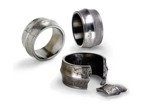

Once bearings start to lose material, they significantly contribute to their own demise. The particulates spalling off a bearing may be as small as 5 microns to 10 microns in size. If these particulates get between the bearing elements, they disturb the film thickness and start to generate rapid temperature spikes consistent with the blackened and burnt oil seen when a pump is taken apart.
Dust in the lubricant works the same way. You cannot eliminate the dust, so you must upgrade the protection. Dust is typically a soft material, but those particulates can actually dent the stainless steel where they are trapped between metal surfaces when the lubrication film is not properly maintained.
Bearing failure analysis
Examine failed bearings the same way you examine failed mechanical seals. Most failures will give at least a hint as to their mode of failure. Five min spent by well-trained personnel may double or triple the life of the next bearing. Untrained mechanics can damage a shaft or pump housing when removing the old bearing or installing the new one. How a failed bearing is removed is just as important as how the next one is installed; removal can damage mating components and fits, and damaged surfaces under the inner race of a bearing cause high vibration and very short service life.
Look for physical damage on the bearing balls or rollers, on the cage that separates the rolling elements, and on the races. Bearing companies have excellent guides for failure analysis-all you need to do is call and request one. This information is usually provided at no charge and can provide a useful resource in evaluating the causes of failure.
