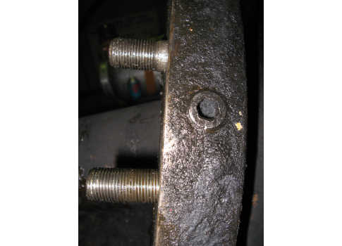

2. Check bolts, nuts and washers to make sure they are correct for the assembly. Are the bolts the correct grade (SAE 2, 5, 8, metric 8.8, 10.9, etc.)? Are the bolts the correct metallurgy such as carbon steel, stainless steel or B7 for high temperature? Is the bolt length correct and threaded length correct? Some joints are designed to keep threaded portions out of shear plane of joint. Before tightening, verify that any shank portion of a screw does not bottom out in the hole as in Figure 11 and Figure 1.2. This will not only lead to damaged threads but will lead to a loose joint as no preload or clamp force will go to the joint even though you will see plenty of torque during assembly. Neighboring bolts will also now shoulder that joint stress and increase the probability of failure.

When key design, assembly or maintenance elements are not carefully attended, bolt failure can result. Some common bolt failure modes are fatigue, overload, stripped threads, shear or corrosion. Fatigue and overload are two of the more common failure modes. Many bolt failures occur at the first engaged thread of the bolt as that is the point of the highest stress. Failures under the head or first thread are also common areas of bolt failure as shown in Figure 2. As long as a bolt is not over torqued on installation then the most likely source for overload is an extreme external load on the joint.
