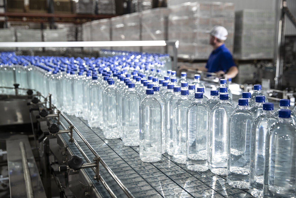

Figure 1: Inline bottling system delivering successfully capped bottles of water. Courtesy: Clarion Lubricants

There are several types of bottling systems used across the food and beverage industry, but two of the most common are inline and rotary bottle fillers and cappers. These systems are found in facilities bottling everything from water, soft drinks, beer and wine to nonbeverage items like dairy products, cooking oils, syrups and sauces. Each type of equipment presents different challenges when it comes to lubrication.

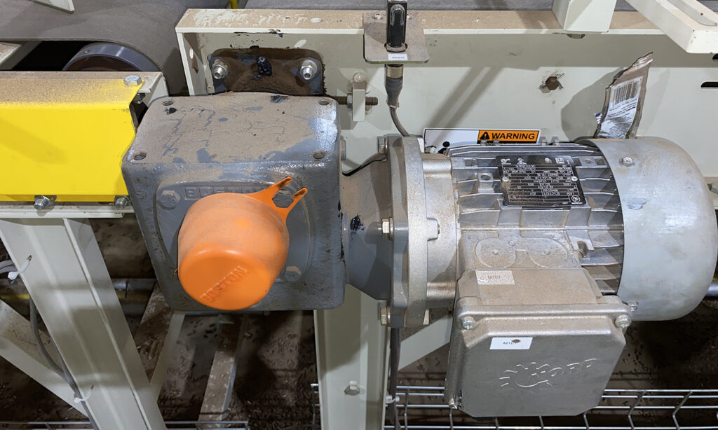

Figure 2: There are a variety of uses for hydraulic motors, including conveyor belts. Courtesy: Clarion Lubricants

Rotary bottling machines are designed for high-speed, high-volume production. They continuously rotate bottles through different stages of filling and capping. Because of their speed, they require lubricants that can withstand intense operational demands.
For these systems, gear oils with appropriate viscosities are crucial. For example:

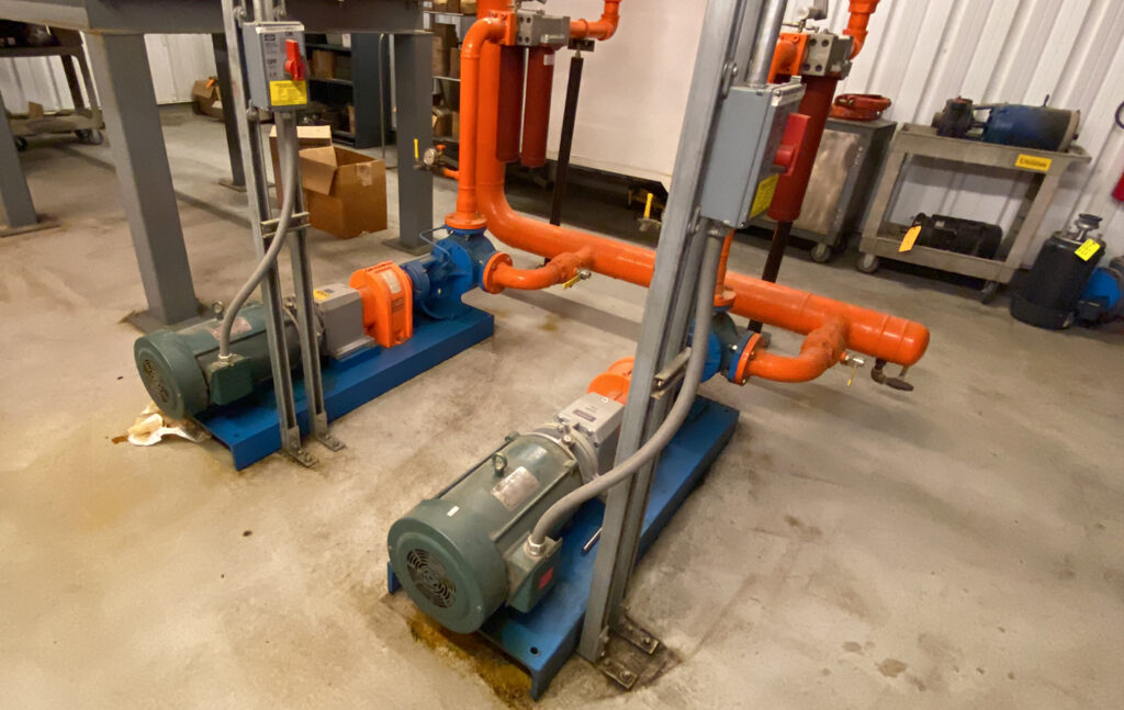

Figure 3: Hydraulics pump feeds the line that is the source of fluid for the entire operation. Courtesy: Clarion Lubricants
  • A lower viscosity gear oil, such as ISO 150, may be needed for machines operating at higher speeds.
  • Higher viscosity oils like ISO 220 may be required for slower-moving parts or equipment that run at lower speeds but under higher loads.
Inline filling machines work differently from rotary systems. They typically have nozzles that enter the tops of bottles to fill them. These nozzles are powered by hydraulic systems, which operate under high pressure and fill the bottles with product. If a hydraulic line fails or blows, there’s a potential for the hydraulic oil to come into contact with the product.

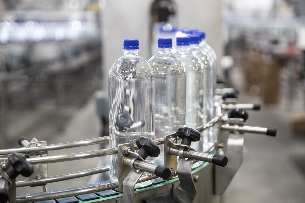

Figure 4: When there are many lines throughout a plant, multiple pumps are needed to support successful operation. Courtesy: Clarion Lubricants
Inline capping systems may also rely on hydraulic pressure to press caps onto bottles or use rotary systems to screw them on.
For this reason, it’s imperative to use the correct food-grade hydraulic lubricant. These lubricants protect hydraulic components while ensuring that any incidental contact with food does not pose a risk to consumer health.

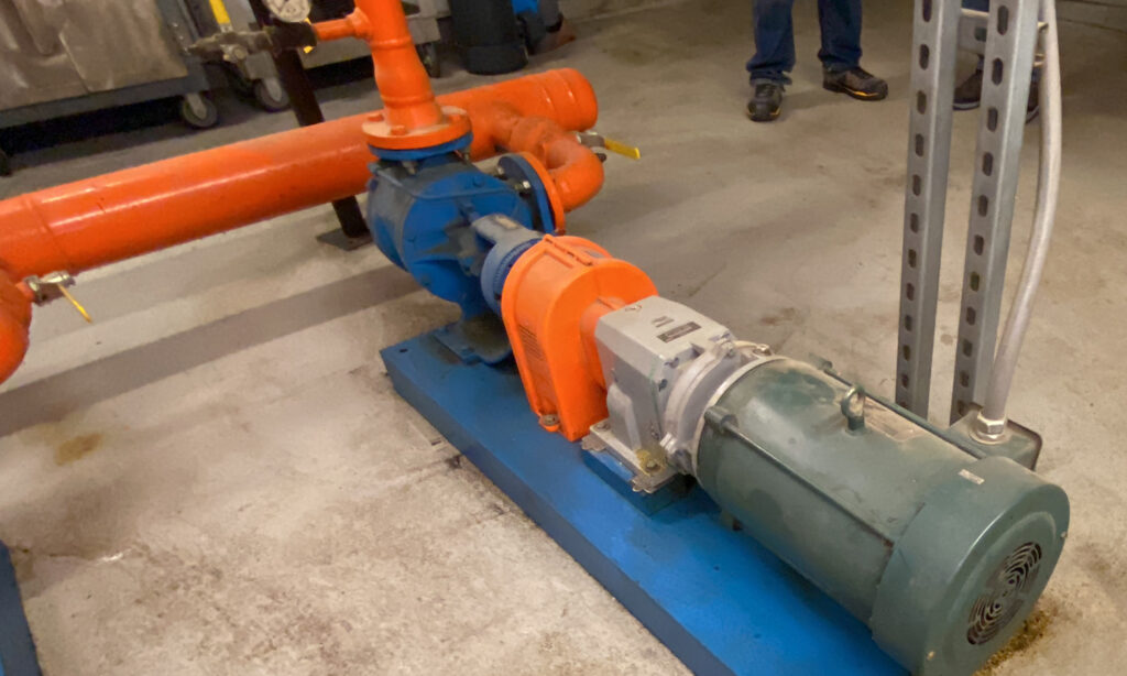

Figure 5: Inline bottling system transporting product to the final packaging stage. Courtesy: Clarion Lubricants

In conclusion, the unique demands of the food and beverage industry mean that not just any lubricant will do. Selecting a suitable food-grade lubricant will help ensure bottling operations run smoothly while remaining safe and compliant.
