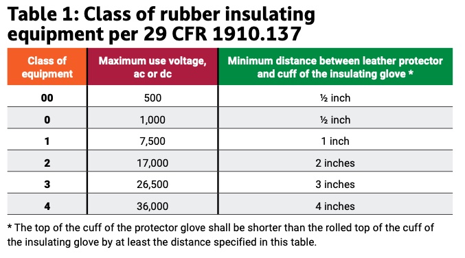

For shock protection PPE, NFPA 70E section 130.7 requires:
Rubber insulating gloves (tested up to the voltage the technician is working with) and leather protector gloves (gauntlets) over the top of the insulating gloves.
Electrical hazard rated footwear (as needed).
Class F or E rated hard hat (as needed).
Safety glasses or goggles (as needed).
Rubber insulating sleeves (as needed).
In addition, to protect against electric shock, it is important to not wear any conductive items (jewelry, belt buckles, etc.) that could come into contact with exposed energized electrical conductors.

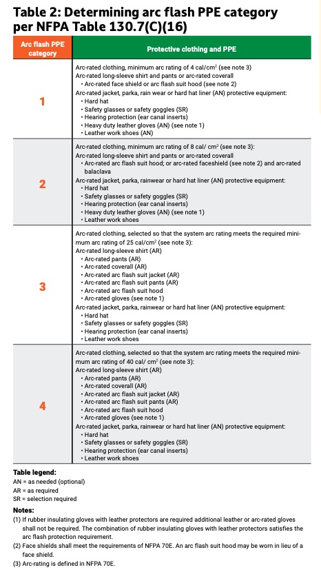

Arc-rated PPE
In addition to the shock protection PPE noted above, if the hazard analysis indicates an incident energy of 1.2 cal/cm2 or more, the use of arc-rated PPE is required. NFPA 70E Table 130.7(C)(15)(a and b) specifies arc flash PPE category 1, 2, 3 or 4.
The higher the category number, the more protective the PPE is to prevent a burn injury. In addition, any underlayers that are worn beneath the arc-rated PPE must also be arc-rated or nonmelting untreated natural fiber. If the risk assessment determines the level of hazard is greater than the available PPE, even if the work is allowed, it should not be carried out.
