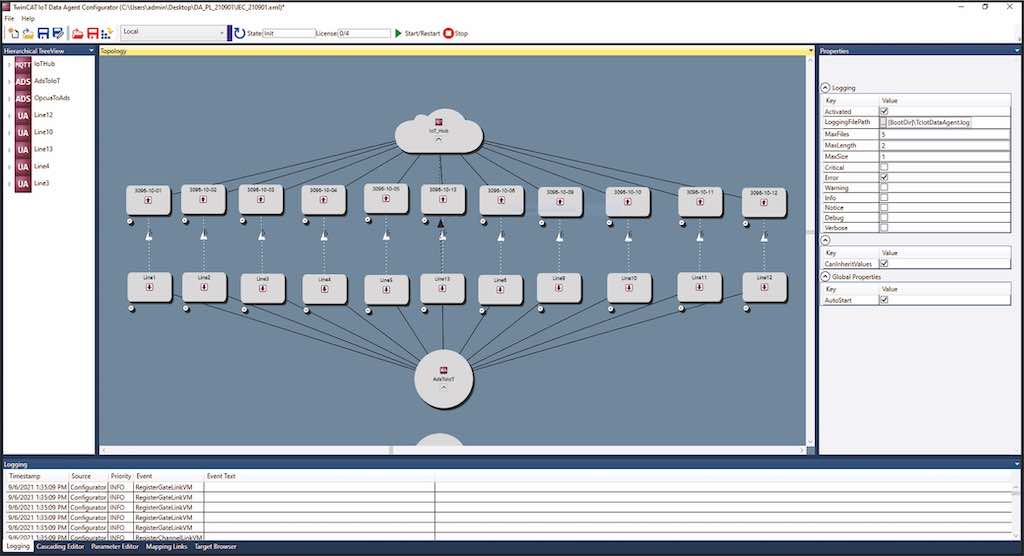

Straightforward configuration in TwinCAT IoT Data Agent was crucial for the Pipelife project. Courtesy: Beckhoff

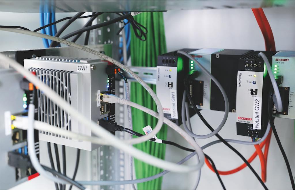

Accordingly, the project managers have standardized and specified the way to integrate the individual machines into the Internet of Things (IoT) network. A C6030 ultra-compact Industrial PC from Beckhoff plays a central role as gatekeeper to the Azure IoT hub in the cloud. Its compact design and multi-core processor performance of up to 3.6 GHz per core make it the perfect edge device, according to Lukas Pechhacker, managing director of HEAP Engineering.
Ultra-compact C6030 Industrial PCs (left) – supplied via Beckhoff PS series power supplies (right) – play a central role as edge gateways. Courtesy: Beckhoff
“This is the advantage of PC-based control technology – the control devices can be scaled to requirements and offer sufficient performance reserves for data pre-processing on site,” Pechhacker explains. “In the case of winders, for example, the sampling intervals are in the millisecond range. That’s why edge computing is used here to translate into revolutions per minute in order to keep the flow of information to the cloud in check.”
The C6030 with TwinCAT 3 IoT Data Agent generally has to take on many “interpreter” functions. On the one hand, it uses TwinCAT ADS and OPC UA to build communication bridges between machines of different ages and different origins. On the other, it also acts as a gateway to the cloud.
“With a total of 197 production sites in 29 countries, we are dealing with an extremely varied machine landscape and numerous protocols that have to be brought down to a common denominator. In some cases, EL6001 EtherCAT Terminals are required as RS232 serial interfaces to establish the required connections; in others, this works via OPC UA,” Pechhacker says.
