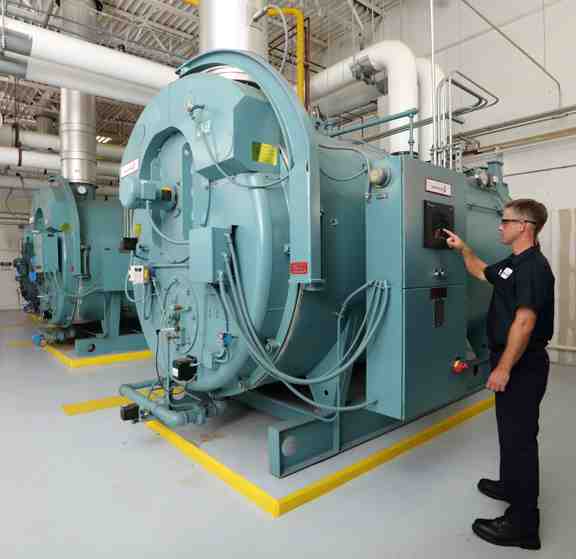

Too often a high-efficiency package boiler is purchased at a premium price and then allowed to decline in performance from lack of proper maintenance or from incorrect operation. Today’s boilers are rugged and finely-tuned machines. Digital burner controls and on-board flue gas analysis make the job easier, but it’s as important as ever to keep an eye on the goal of optimum efficiency.

Zala also points out that newer boiler controls often use an O2 sensor to optimize combustion. This means many fewer adjustments of draft and fuel linkages are needed than with older mechanical controls. However, he says, “Typically the sensor requires periodic calibration. Some control systems are designed to perform automatic calibration.” Check with the control system provider to confirm the status of your system.
Chad Fletcher from Hurst Boiler emphasizes the importance of regular maintenance and echoes comments of others on the importance of maintaining feedwater quality. He points out, “The newer technology digital controls do offer easier maintenance and offer easier setup and dealing with problems.” He notes that much of this maintenance work can be done during the bi-annual boiler inspection.
Flue gas analysis will give information on boiler efficiency. Typically you want excess air less than 15% and no measurable carbon monoxide (CO). This will indicate clean combustion. Higher excess air or the presence of CO indicates adjustments are needed. If your boiler offers on-board flue gas analysis, then be sure to take advantage of  this very useful tool.
