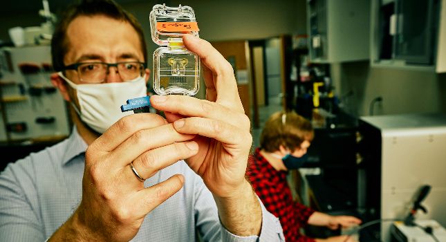

A team led by Stephan Warnat, assistant professor in the department of mechanical and industrial engineering in MSU’s Norm Asbjornson College of Engineering, has developed a new method of using 3D printing to make devices for microfluidics, which involves manipulating very small volumes of liquid to measure water quality or study microorganisms, among other things.
“It’s a big step,” said Warnat, who described the advance in an article published in a scientific journal and then featured on 3dprint.com. “We’re excited that our idea works the way we thought it would.”
Using the new method, Warnat’s team demonstrated that they could 3D print directly onto glass to form the thin channels — less than a millimeter wide — that contain the liquid. The new process significantly reduces manufacturing time and could allow researchers to easily produce affordable, customized prototypes of the devices, called microfluidics chips, in their labs.
“The turnaround is maybe a day, from start of production to final testing,” said Warnat, who estimated that materials used to make a typical chip using the new method cost about a dollar.
Typically, the channels are formed with an etching process or by masking areas of the chip and chemically depositing thin strips of material. It’s important that the chip is glass because researchers usually want to view the channels with a microscope. However, 3D printing directly onto glass had proven elusive until Warnat and his collaborators figured out how to bond the printing material to the transparent substrate. Moreover, the 3D printing material bonded well not just to the glass but to small sensors made of very thin sheets of metal. That means the sensors can be easily integrated into the microfluidics chips.
Michael Neubauer, an MSU graduate student who co-authored the article with Warnat, used the Montana Microfabrication Facility at MSU to make the metal sensors, which he described as looking like interlocking fingers that can measure changes in electrical current to detect certain minerals in water, for instance.
“These 3D printers are pretty much available to anyone,” Neubauer said, who is working toward a doctorate in engineering with a focus in mechanical engineering. “Really what we’ve done is bring these techniques together in way that’s straightforward and that most people can accomplish in their labs. The hope is that other experts in their fields can follow these methods to come up with applications that are really cool and interesting.”
