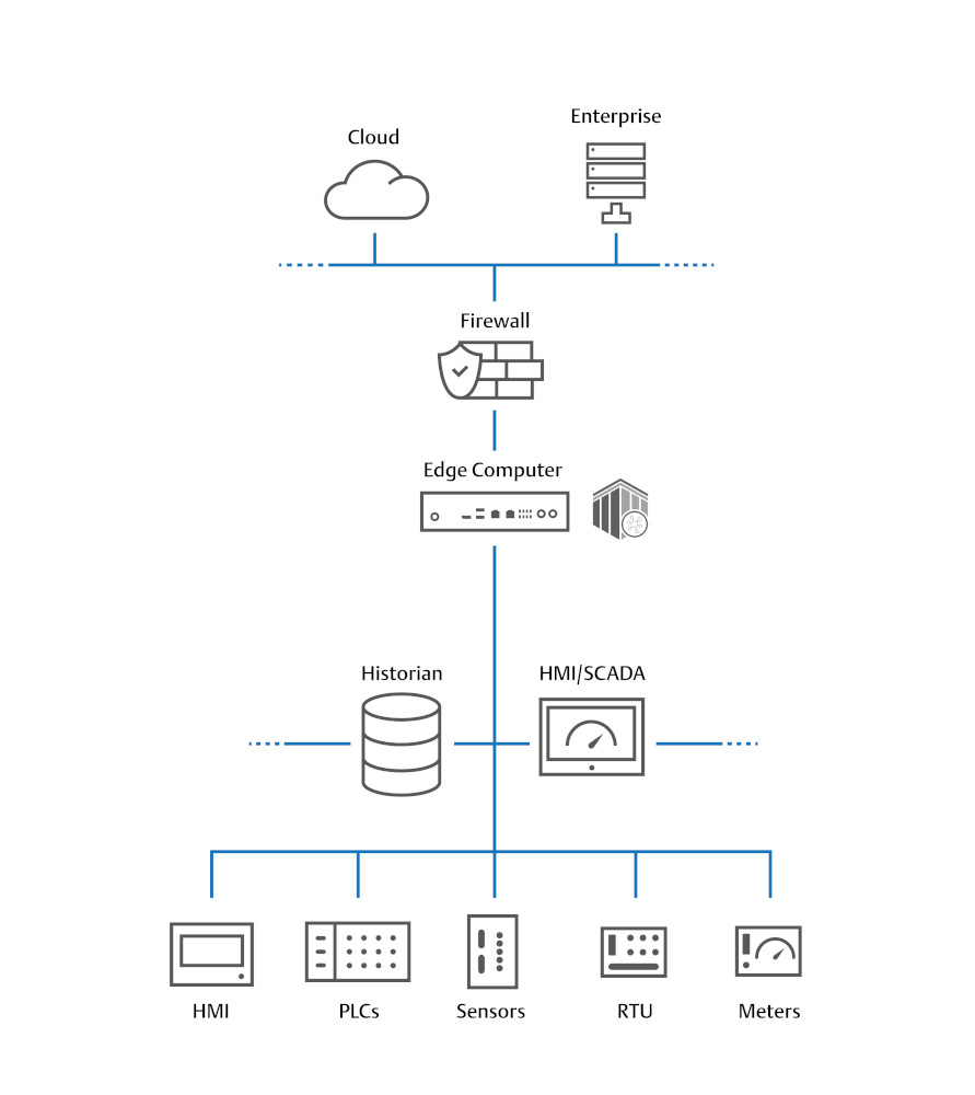

In many cases, it is desirable to have this remote monitoring and adjustment capability supplemented with more of a closed-loop control scheme. For this role, an edge controller is most appropriate because it provides the general-purpose computing needed for data collection, processing, visualization, and sharing, supplemented by the real-time deterministic control necessary to execute control logic in the most reliable manner.
An edge controller compresses the hardware architecture because analytics are performed at the edge of the process—and perhaps may be integrated with cloud resources—yet can be applied for autonomous control (Figure 2).
