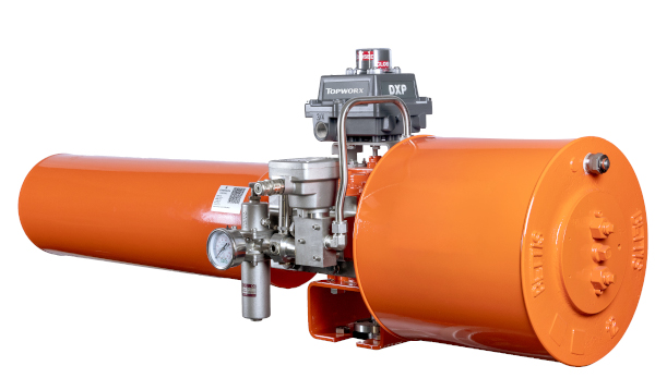

Figure 1: Continuous remote monitoring solutions, like the one integrated into this pre-engineered Bettis VOS-PAC actuation package from Emerson, provide plants with a view of processes and valve package condition. Courtesy: Emerson

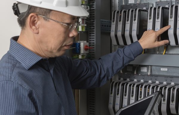

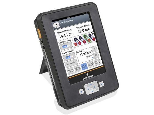

Figure 2: Emerson’s AMS Trex device communicator enables plant personnel to access real-time data such as valve health, and immediately diagnose device issues plant-wide. Courtesy: Emerson

One of the biggest challenges refineries face is they don’t have a way to measure critical parameters. Some have valve packages that are quite old, and there’s no existing infrastructure in place to enable remote monitoring. Turnarounds can provide an opportunity to integrate solutions that start building the infrastructure and shorten these complicated, expensive downtime events.

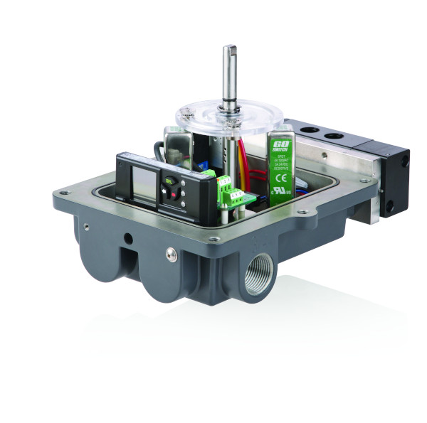

Many solutions can be used as part of a turnaround to monitor performance or can be connected at a later stage to be implemented into other systems. For example, a discrete valve controller with an integrated HART 7 module can be retrofitted to any existing switchbox solution. The on-off switch can be independent of the HART signal, and a HART 7 solution can be installed for future scope using the existing system’s on-off switch. A hand-held diagnostic communicator can be used to access real-time data from the dormant HART 7 module, since the HART 7 internal memory holds this data under power.
Figure 3: As they use open-source data, Emerson’s TopWorx DX-Series discrete valve controllers may be used independent from a control system; Emerson specialists can produce valuable graphical data that informs a plant’s decision making. Courtesy: Emerson
Accessing data with a device communicator allows end users to quickly analyze current valve health and make informed decisions based on that analysis. Confidently knowing valve condition can speed up decision making and action, which can shorten the turnaround.
Mobile device communicators also can help technicians properly diagnose and address problems anywhere within a facility, replacing invasive physical investigation and the potential destruction it causes. Because equipment can continue running during troubleshooting and repair, communicators not only streamline maintenance, they also minimize downtime (see Figure 2).

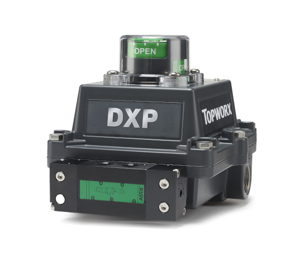

Figure 4: With sensing and feedback contained within a single housing, Emerson’s TopWorx DXP discrete valve controller provides a clear picture of valve package condition as well as diagnostics. Courtesy: Emerson

Shortening the length of turnarounds is one way to improve plant efficiency. Another way is reducing the need for turnarounds and shutdown maintenance in the first place. Yet, on-off valve assets in many plants require frequent maintenance and support to prevent catastrophic failure. Understanding actuator and valve wear through remote monitoring and diagnostics can make this maintenance more efficient, helping decrease downtime and costs.

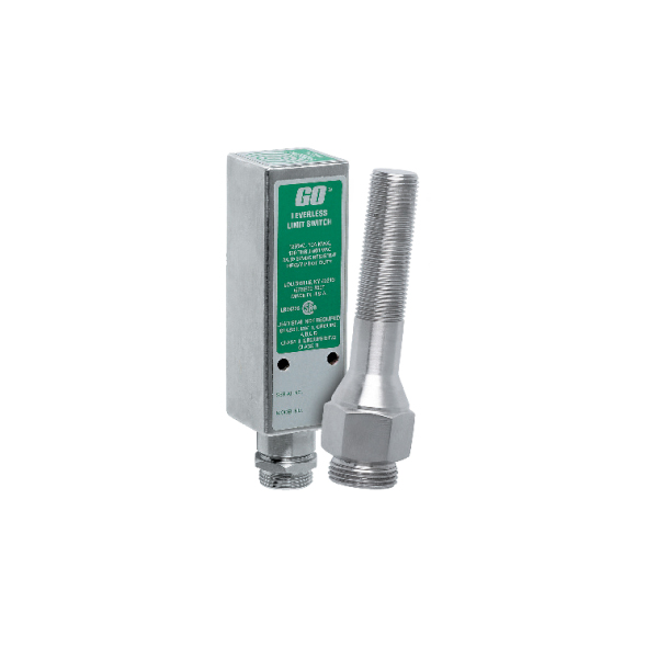

To do this, facilities can use a discrete valve controller that combines sensing and feedback in a single housing to improve the visibility of valve package condition and deliver diagnostics. This integrated switchbox solution includes a sensor, HART 7 module and other components such as a solenoid valve for piloting. In process facilities, it sits on top of an actuator/valve assembly, where it continuously monitors assembly performance in real time and enables the delivery of preset diagnostics vital to assembly health (see Figures 4 and 5).
Figure 5: The DXP controller features Emerson’s TopWorx GO Switch sensing technology, which monitors valve position in hazardous areas. Courtesy: Emerson
The sensor collects data the HART module then transmits to a control system. The control system then delivers analytics and diagnostic notifications to handheld devices or workstations. There, operators and technicians can see the data in dashboards and receive alerts, make decisions and take appropriate action. Critical parameters that reveal the current state of valve and actuator wear include valve state measured by position percentage, transition dwell time, last open/close stroke time, internal device temperature and cycle count. Operators can continuously observe these factors to assess current conditions, determine remaining life expectancy and maintain assets as they age (see Figures 6 through 8).

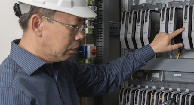

Figure 6: Emerson’s DeltaV Distributed Control System (DCS) visualizes real-time process data, trends, historians, alarms and other critical data personnel can access on demand through handheld devices or workstations. Courtesy: Emerson

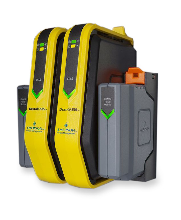

Figure 7: During DeltaV lifecycle services, safety instrumented system (SIS) modification services, Emerson-certified specialists apply auditable, established procedures that ensure SIS is up to date in accordance with the IEC61511 Safety Life Cycle. Courtesy: Emerson

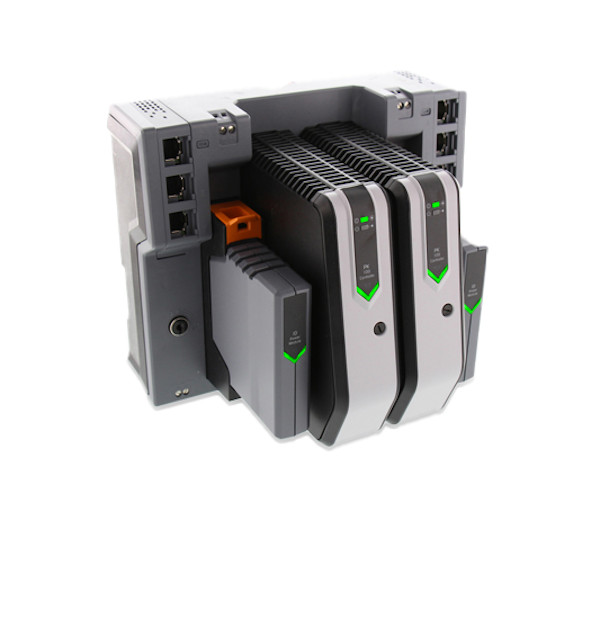

Figure 8: Emerson’s DeltaV PK Controller can act as a powerful standalone system and easily integrate into a larger DeltaV system. Courtesy: Emerson
