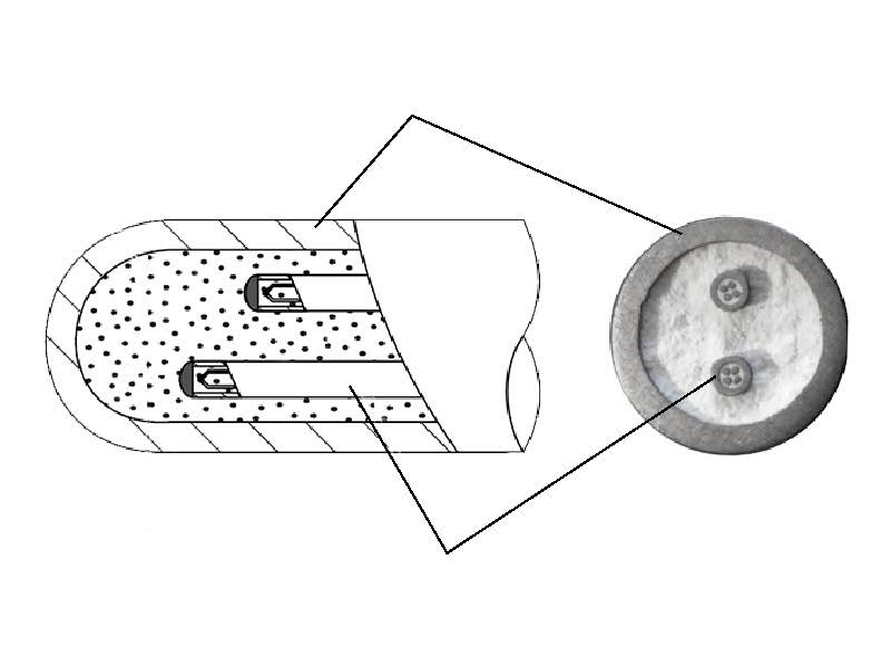

The minimally invasive Endress+Hauser iTHERM ProfileSens TS901 multipoint cable probes consist of two or more independent temperature sensors embedded in a common outer metallic sheath. The outer sheath acts as an integrated thermowell, while the space between the sensors is filled with highly compacted insulating MgO mineral powder (see Figure 2).
Since the two sensors are completely independent from each other, contamination of the outer MgO powder does not affect the inner sensors’ electrical circuits and their operation. New, patented technology introduces a second layer of protection. An additional metal barrier isolates each measuring circuit within its own MgO bed, providing full sensor independence. This double protection layer results in extremely high sensor reliability, similar to a separate thermowell, while maintaining the flexibility characteristics of bendable cable probes.
Multiple thermocouple sensors can be grouped within a single probe, each delivering the required measurement performance. The probe layout and routing, length, and the number of sensors is individually adapted to process specifications. This type of design is proven in use to significantly lower the risk of premature sensor drift, corrosion, and short circuits.

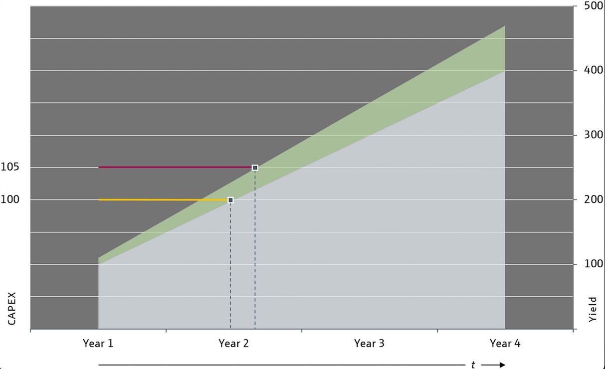

The newer design increases the usable catalyst bed volume by 50 percent and cuts installation time by 75 percent. The increased volume can be used to boost the catalyst load, and the saved installation time directly translates into quicker turnarounds and lower cost.
Measured against an average daily unit profitability and a continuous operation of 36-48 months, the resulting extra revenue generated fully offsets the CAPEX (see Figure 3).
With iTHERM ProfileSens, the initial CAPEX (left y axis, base 100: standard multipoint installation), while minimally higher, is quickly offset through higher yield (right y axis, base 100: standard multipoint installation) and savings. The major factors leading to this quick return on investment are:
- Higher unit performance and conversion
- Higher efficiency
- Faster installation and turnaround
- Lower OPEX.
As the number of measurement points increase, the savings effect grows to the point where the initial investment becomes negligible when compared to the increased returns. The new technology’s robustness, reliability, and longer operating life makes it a compelling choice for harsh process conditions.
