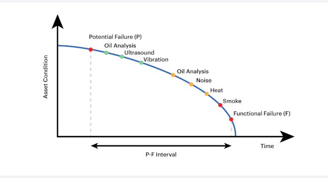

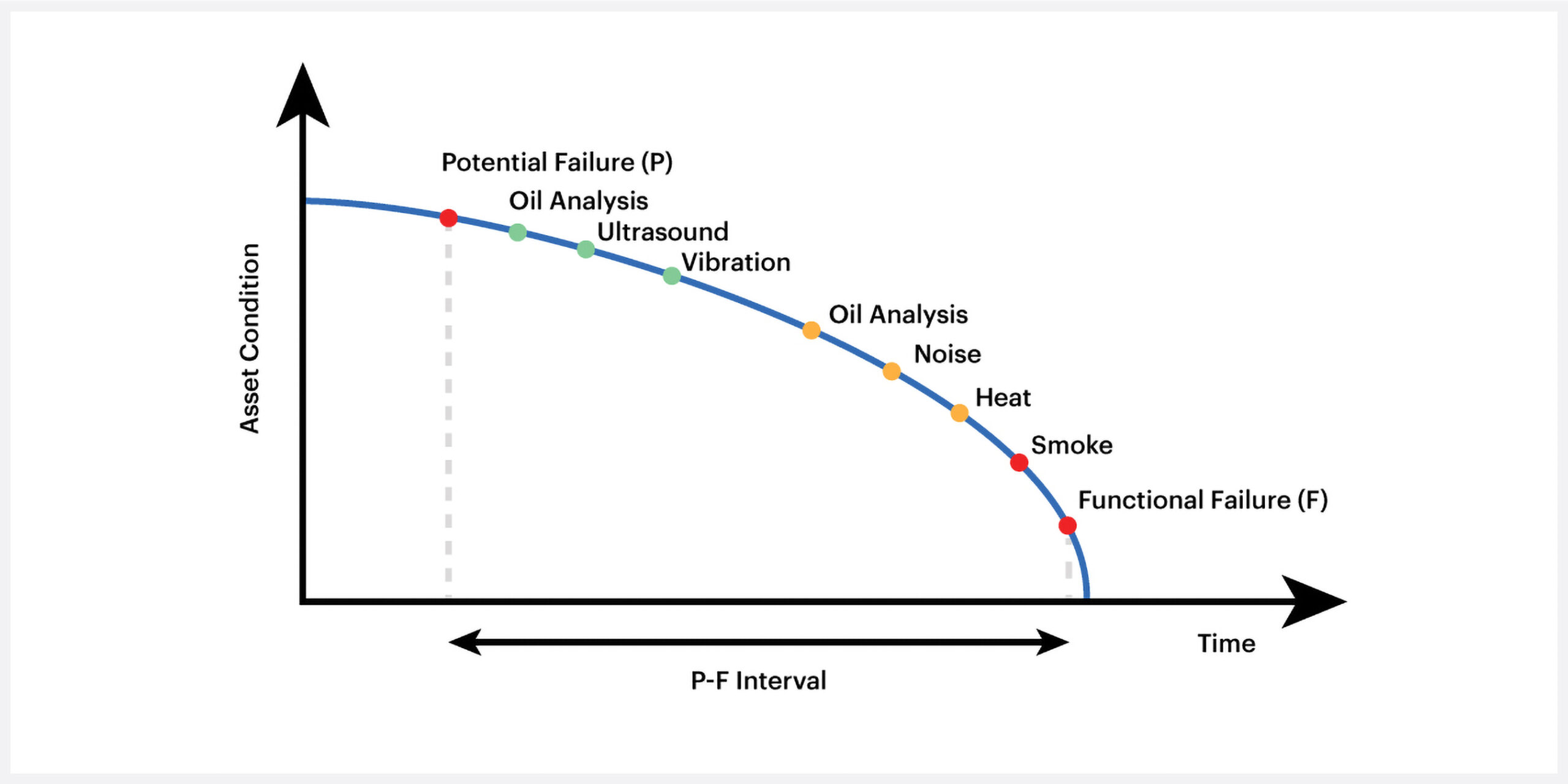

Figure 1: In a potential failure (P-F) curve, oil analysis is used early to reveal if the oil is degrading or contaminated, to avoid issues that will cause the equipment to begin failing. If needed, it also can be used later in the interval to identify wear metals. Courtesy: Motion

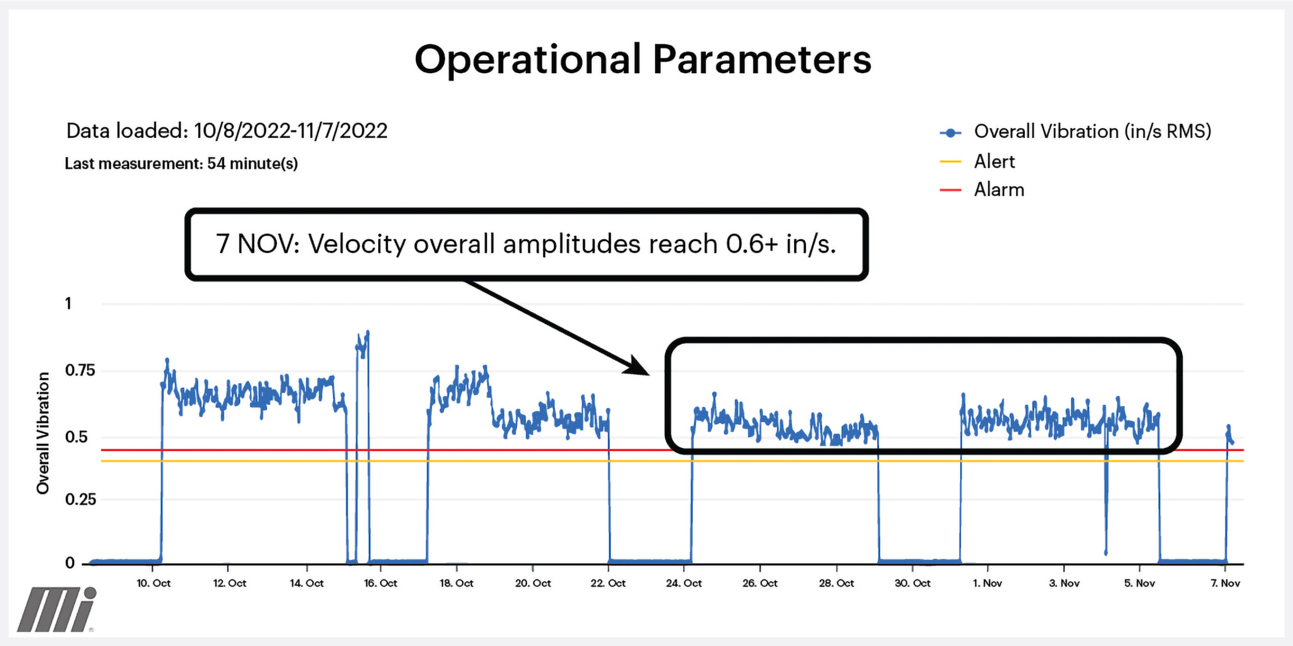

Vibration analysis detects abnormal vibration patterns in machinery, indicating problems such as misalignment, unbalanced components, lubrication issues and bearing failure. Vibration analysts can review vibration trend plots to pinpoint the problems by comparing the patterns that develop in the frequencies captured against known patterns associated with common failure modes (see Figure 2). The most common techniques for vibration analysis are route-based data collection using handheld vibration collectors and online monitoring, either wired or wireless.

Figure 2: Vibration trend plots pinpoint developing problems. Courtesy: Motion
