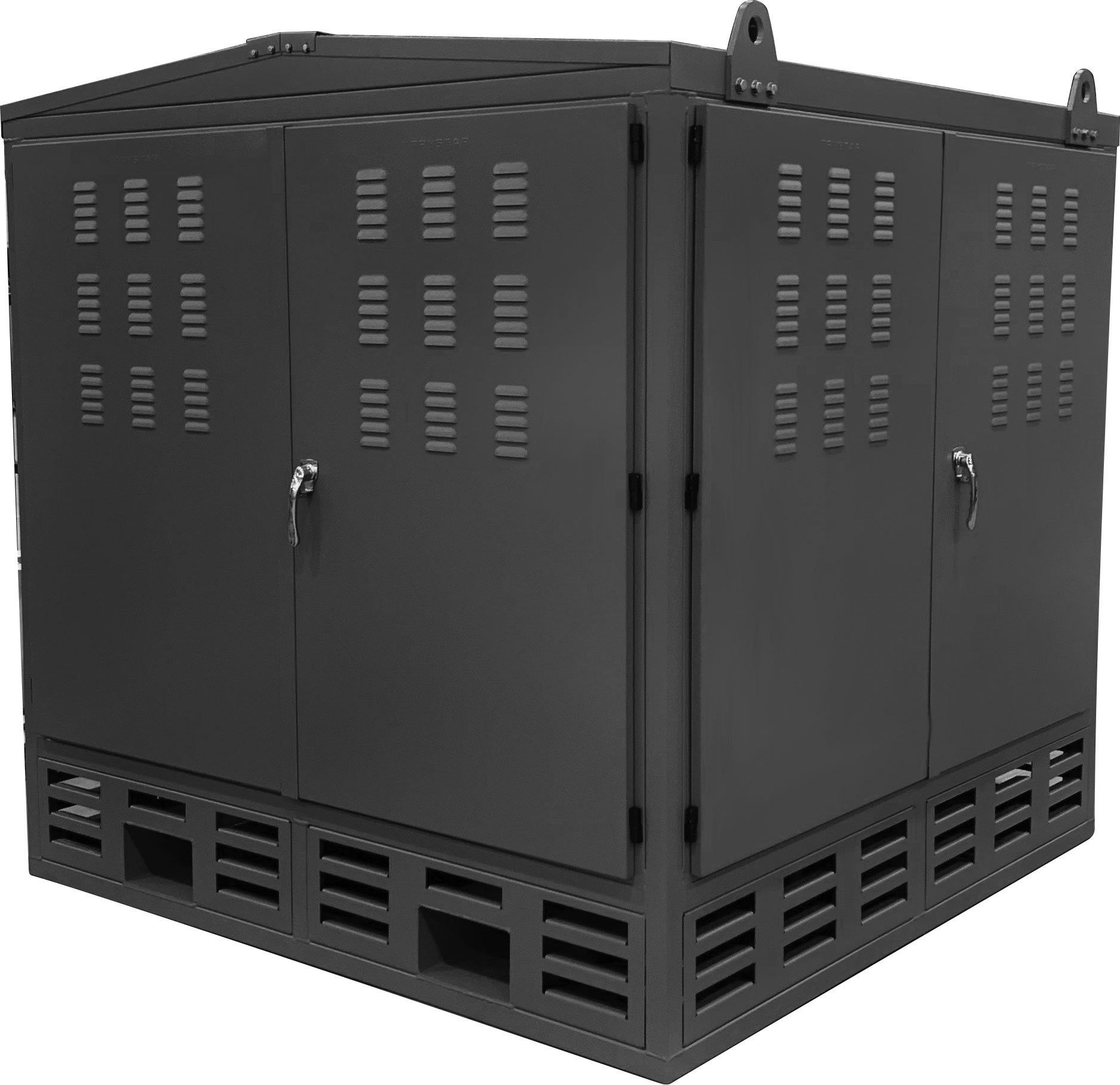

A 12000-A common bus enclosed in a NEMA-3R enclosure to facilitate power distribution from multiple paralleled generators used to support large-scale events and facilitate industrial facility maintenance and service outages. The new enclosed single common bus design provides up to 64 600MCM termination points per phase and neutral and 32 600MCM termination points per ground. It’s perfect for distributing power across large construction sites. It can also feed multiple downstream panels, equipment, and transformers. The common bus is also designed to be portable, durable, and put into service quickly.
The standard 78-in. width makes it easy to transport by semi-trailer, and Integral skid pockets and bolt-on lifting eyes make it easy to move and place. Access from four sides facilitates quick and easy wiring for setup and disconnect. The portability and easy hookups make it ideal for use in multiple locations because it is easy to pack out and move.
A NEMA-3R enclosure and powder coat finish increases durability and optimum performance by resisting dust, debris, and weather-related conditions. The common bus enclosure features vented side panels to reduce internal temperatures for maximum loads without an auxiliary fan. An integrated bottom rake deters cable theft, and locking latch doors help ensure continuous operation by limiting tampering and unauthorized disconnection. The slanted roof helps prevent water intrusion in robust conditions.
