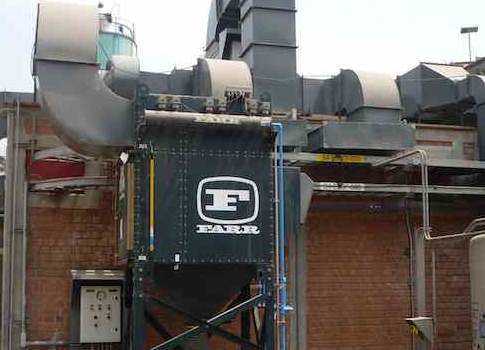

Dust collection equipment selection
If your analysis determines that dust collection is the most cost-effective approach, here are some general guidelines on the types of equipment best suited to pressurizing.
Type of dust collector: Cartridge style dust collectors are the system of choice because they typically offer much higher filtering efficiencies than traditional baghouse collectors, a necessity when protecting workers or sensitive equipment from high levels of fine dust. Cartridge collectors also operate at lower pressure drop, for more efficient performance. The dust collector will be located outdoors, so make sure it is equipped with weather-resistant components and controls.
Wet scrubbers: When pressurizing to protect a space from gaseous contaminants, a wet scrubber system should be used. If dust is present, however, you will still need the cartridge dust collector for particulate filtration installed upstream of the wet scrubber.
Filter media: A very-high-efficiency filter (MERV 15 or 16) is recommended for pressurizing applications. Cartridge filters using nano fiber or other high-efficiency filtration media are especially well suited to this use. Typically, an outer layer of extra filtration fibers will ensure the maximum efficiency of the media from the very first day. This technology increases the efficiency and allows maximum filtration with low pressure drop, thus improving the energy performance of the system.
Don’t rely solely on MERV values or filter efficiency percentages to predict performance, however. Although these measures are useful for comparing different filters, it is more important to ascertain that emissions will be at or below required thresholds. Ask the filter manufacturer for a written guarantee of emissions performance stated as grains per cubic foot.
As noted, cartridge filters will need infrequent change-out in pressurizing applications, but it is good practice to replace filters every two to three years. An older filter may develop a hole or leak after time and will no longer deliver the guaranteed efficiency.
HEPA or safety monitoring filters: HEPA or after-filters, also known as safety monitoring filters, may be added to the ductwork downstream of the collector to provide an extra measure of protection for critical applications. In the unlikely event of an air leak through the dust collector filters, the after-filters will provide backup protection. In certain cases, HEPA filters will be required to comply with regulations of a specific industry.
Carbon after-filters: This option is available when odor control is desired. For example, for occupied spaces it may be a good practice to use carbon after-filters to prevent outside odors from entering the pressurized space.
Variable frequency drive (VFD) and pressure sensor: A VFD drive provides precise electrical control of dust collector fan speed and is highly efficient in maintaining the desired airflow through the collector. It is a must for pressurized applications, and should always be used in conjunction with a pressure sensor in the room. The two devices will work in tandem to monitor and control pressure.
