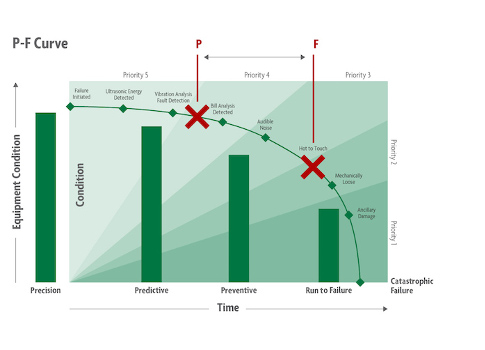

In the context of a preventive versus predictive maintenance methodology comparison, it’s important to review and understand the Potential Failure (P-F) curve. An asset’s failure is often thought of as an event rather than a process. However, most malfunctions occur over time. The P-F Curve (Fig. 1) illustrates an asset’s deterioration over time. Essentially, the P-F Curve offers tremendous value as a forecasting or early warning tool. This concept applies to each component in a machine.
The P-F Curve’s horizontal (X) axis represents time while the vertical (Y) axis represents condition. As an asset gradually deteriorates, the potential failure (P) is the point in this process when it is first possible to detect that a bug or loss of function is imminent. If a flaw remains undetected and unmitigated, the deterioration process accelerates until the asset experiences functional failure (F). The time range between P and F is referred to as the P-F Interval, which could range from days to weeks to months, depending upon the specific component.
Maintenance leaders can use the P-F Curve to challenge and update the OEM’s recommended PM activities. The quantity of these PM activities can be reduced by efficiently scheduling these tasks based on the historical data provided by the P-F Curve. Unfortunately, many organizations fail to recognize the value of the P-F Curve or put forth the required effort to collect and analyze the historical data. Thus, the PM activities remain status quo.
PdM’s real-time, condition-monitoring process provides the best opportunity to take advantage of the P-F Curve’s "crystal ball" data and avoid functional failure, provided the condition-monitoring equipment data is properly interpreted. As a result, the replacement or restoration of an asset’s component(s) can be properly planned and scheduled before a total functional failure occurs at the earliest convenience. Additionally, PdM requires fewer productivity disruptions than the intervention process required by PM.
