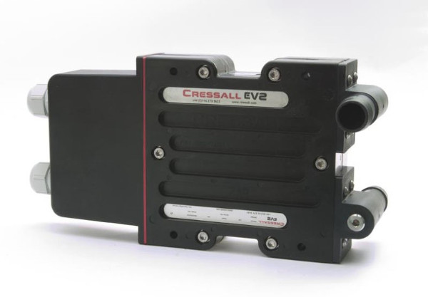

Figure 2: Cressall’s EV2 water-cooled dynamic braking resistor (DBR) has a unique design, meaning it takes up just 10% of the volume and 15% of the weight of a conventional air-cooled DBR. Courtesy: Cressall Resistors

An essential component of any EV is its dynamic braking resistor (DBR). Heavy duty applications like mining require heavy duty components to withstand the tough operating conditions they face.
When a mining vehicle brakes using the principles of regenerative braking, the first option is to store the excess energy produced in the vehicle’s battery for reuse, which improves the energy efficiency of the vehicle and keeps the system operational for improved safety.
However, when the battery is close to its full charge, this is not possible. A dynamic braking resistor is the simplest, most reliable and cost-effective solution to this problem as it dissipates the excess energy as heat, allowing the EV to stop when required. This is particularly useful in mining applications, where operational efficiency and reliability are crucial.
Cressall’s EV2 water-cooled DBR has a unique design, meaning it takes up just 10% of the volume and 15% of the weight of a conventional air-cooled DBR (see Figure x). Units can be combined in up to five-module assemblies to meet high-power requirements.
