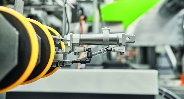

There already are some pneumatics products with edge gateway capabilities built into their electronics platform (see Figure 1). Many manufacturers are developing industrial IoT gateways that analyze various sensor signals and use the results to generate informative process information. To monitor the wear of a shock absorber in a pneumatic cylinder for example, the edge gateway would analyze the end-stroke sensor signals to evaluate the cushioning efficacy (see Figure 2). The system can intelligently route this information to the right people, without the use of the machine controller. This concept alleviates the need to modify the controller program which minimizes the risk of machine downtime and has the potential to substantially lower operating costs by identifying failing components before they stop and cause unscheduled downtime.
