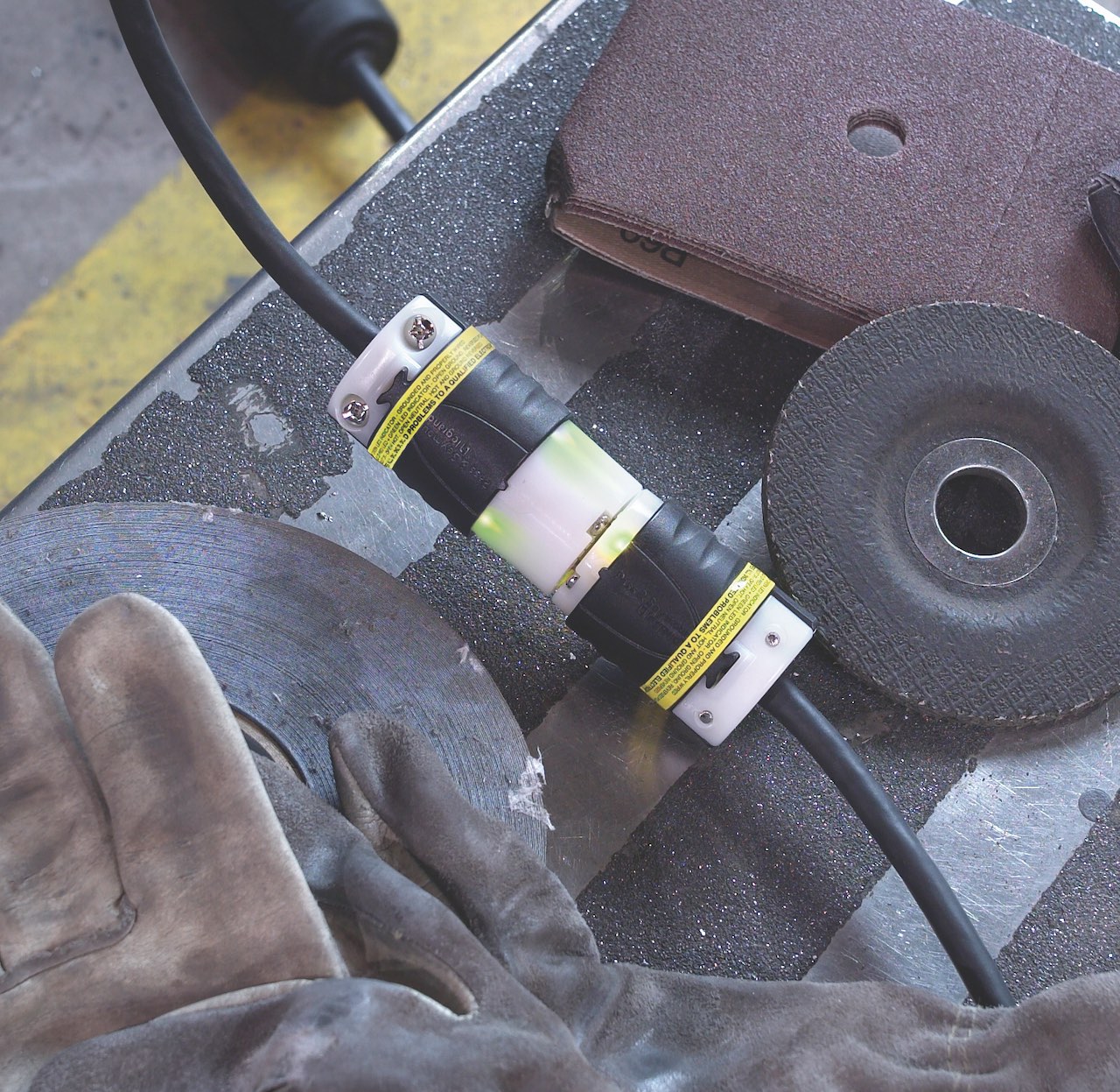

Dust-tight plugs and connectors
Dust-tight plugs and connectors are rugged options for both commercial and light industrial applications, such as dry outdoor use with shop tools and extension cords. The dust-tight body is made of rubber, providing resistance to impacts, oils, chemicals, heat, and weather. Many dust-tight plugs, and connectors are constructed with floating, nickel-plated blades that allow for self-alignment with contacts and provide long-lasting corrosion resistance. These items do not allow any dust ingress, making them a superior choice for many light industrial applications.
Dust-tight plugs and connectors are perfect for dry outdoor environments, shop tools, and extension cords.
