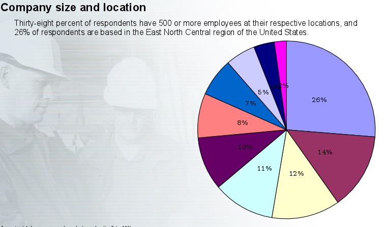

The study was completed in November 2013 and surveyed safety managers, plant managers, maintenance supervisors, and senior management. Almost two-thirds of respondents were involved in engineering or maintenance. Full results of the survey are now available at www.PlantEngineering.com.
