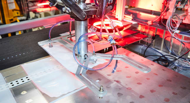

The engineering team prioritized system openness, which is necessary to increase data acquisition and to integrate third-party components and software in real-time. For example, Labplas wanted to upgrade its assembly technology to form sampling bags and insert the sampling accessories, such as sponges, cloths, spoons or scissors with a robot arm. Previously, operators manually inserted sponges and placed kits in the finished open-top bags. To achieve the design upgrade of the MM line, Labplas considered different form-fill-seal partnerships and designed a way of integrating this equipment with a six-axis robot.

New machine designs included multiple PC-based control solutions, motion control hardware and universal automation software with kinematics. Labplas used robots across 15 lines, and the pick-and-place robots and other motion axes are fitted with servomotors controlled by EtherCAT servo drives. The high-performance synchronous servomotors provide very low rotor inertia and a very high overload capacity for dynamic applications. They connect to the drives using a one-cable design, which reduces wiring by combining power and feedback. The servo drives feature fast control algorithms with minimum current control, speed control and position control of 62.5 μs. “The servo drives must deliver incredible precision and acceleration for the servomotors, especially for the delta robots,” Fontaine said.
Using TwinCAT Kinematic Transformation software with Codian pick-and-place robots, along with other upgrades, made insertion of sampling implements six times faster. Courtesy: Beckhoff[/caption]
