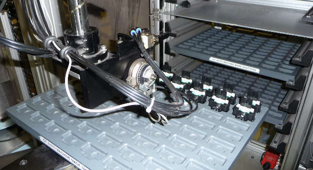

“Some of the seals can be easily dislodged so we needed quite a precise system,” Talbot said. “The SCARA robot uses sensitive parallel grippers to pick a raw body from a bowl feeder and place it on the table. Then, from the next unit clockwise around the table it picks up a completed assembly. This assembly is then rotated through ninety degrees so it’s in the correct position to be packed and secured.”
The packing trays are located on a Cartesian robot arm, held there using a vacuum attachment, and the 72 units are arrayed in rows of eight by nine. This robot arm presents the tray to a common position and it stays there until it’s loaded. The tray is then replaced back into the magazine from which it came. The Cartesian then selects the next tray down, moving down its vertical axis.
The magazines are manually replenished and the full trays are taken out and stored or moved onto the next step of the process. To ensure personnel safety, there are a series of light guards to stop the operator opening the door. If the door is opened, the robot is prevented from entering the area by the light guards.
