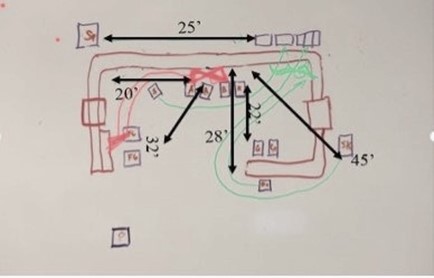

The Kaizen team’s observations identified many areas of waste. There was no standardization on how the packaging line was set up or run by the two manufacturing teams that each worked a daily 10-hour shift. Pallets in the work area were not staged near where their contents were used in packaging, requiring extra time to move pallets out of the way to position other pallets. The layout of the line’s packaging operation extended the operator’s walk to palletize the finished goods.
The operators and material handler were not informed of the next product that would be produced on the line, so they were not prepared. This extended the changeover time between products. Roller conveyors and rails were not adequately maintained. This required the operators to individually handle each box, which decreased productivity.
In addition, the operation had ergonomic issues. It required too much twisting and bending to load materials into the finished goods boxes.
Actions taken from the Kaizen team

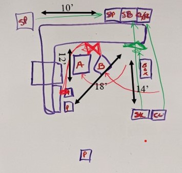

After mapping out the existing workflow and observing areas for improvement, the team brainstormed a new workflow map. They cleaned up the work area and positioned pallets of kit boxes and components near their use points. They moved the overall packaging operation closer to the palletizing area. They tested different arrangements and operational sequences to determine the best approach. Once the team identified a best approach, they temporarily marked and labeled areas for the pallets with tape. Permanent identification and placement lines for the pallets will be painted after the operators work with the layout and determine what adjustments are needed.

Using the team’s selected layout and work approach, cycle time dropped to 13 to 14 minutes per pallet, a decrease of more than 35%, based on sample measurements made over 3 days and after the 90-day audit. Other layouts and approaches the team tried out resulted in cycle times ranging from 18 to 27 minutes per pallet so these options were dropped. Running with the new approach and layout, OEE increased to 87.7% during first shift on the last day of the Kaizen event. Three months after the event, the line averaged 87.6% OEE across both shifts, a 66.5% improvement from the baseline of 52.6% and well above the company’s 70% goal. This was achieved by implementing eight of 26 improvement ideas identified during the Kaizen event.
