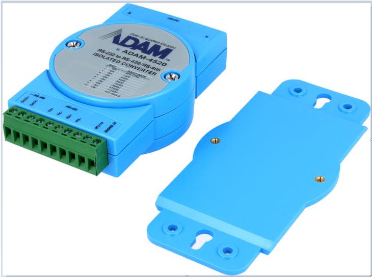

Enabling convenient communication among equipment supporting different serial interface standards, the Advantech ADAM-4520-F is an RS-232 to RS-422/RS-485 converter module capable of delivering 115.2kbps data rates. By attaching one of these units to equipment that was originally fitted with RS-232 interfacing, it is possible to convert the RS-232 signals into isolated RS-422 or RS485 signals. Through its use, communication distances of up to 1200m can be supported and as many as 32 nodes connected. There is no need to change software, thereby facilitating the upgrade process. As well as having 3kV galvanic isolation, this module has a built-in surge protection mechanism. An operational temperature range of -10 to 70°C is covered. Supplied in a compact ABS enclosure (with 70mm x 122mm x 30mm dimensions) it can be DIN-rail or panel mounted.
Figure 1: The ADAM-4520-F RS-232 to RS-422/RS-485 converter module from Advantech converts networking protocols to improve industrial communications. Courtesy: TME

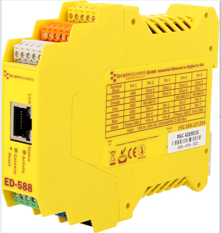

Supporting the Modbus TCP protocol, the Brainboxes ED-588 Ethernet gateway allows existing industrial equipment to interact with the enterprise infrastructure further upstream. It offers a robust and intelligent “control side” device that provide the interface to systems on the factory floor environment, commonly referred to as “process side.” It has 8 non-isolated digital input and 8 non-isolated digital output channels. The Ethernet port enables data to be transferred at 100Mbps rates. This DIN rail-mounted unit is supplied in a compact form factor (with dimensions of 101mm x 128mm x 22.6mm), minimizing cabinet space. These units can be attached to a 24V supply, and are housed in insulated polyamide casings which are IP20 rated. It may be used to control fans, solenoid valves, reed switches, lamps, or motors. In addition, the gateway can deal with data coming from many sensors. No software is needed, as the unit can be accessed from a web browser. Since it is installed as a COM port on a Microsoft Windows PC, it has full backward compatibility with older equipment models. Short circuit and ESD protection features are incorporated, as well as over-temperature shutdown. An operational temperature range of -30 to 80°C is supported.
Figure 2: The ED-588 Ethernet gateway from Brainboxes can help with retrofitting older machinery to modern industrial communications. Courtesy: TME
