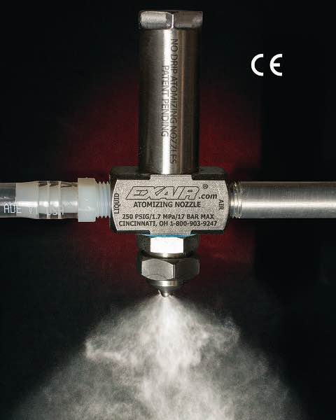

The Siphon Fed atomizing spray nozzles stop liquid flow when compressed air is shut off and can be used when no post-spray drip is permissible.
Siphon Fed atomizing spray nozzles require no liquid pressure and can be used with gravity fed liquids or lift liquids from a siphon height as much as 36 in. Siphon fed nozzles can be used on liquids up to 200 centipoise. No drip Siphon Fed atomizing spray nozzles stop liquid flow when compressed air is shut off. Unwanted drips can ruin product function on sealing or mating surfaces. In addition, excess liquid flow wastes precious resources such as expensive coatings, chemicals or water. These nozzles can be used when no post-spray drip is permissible. Applications include painting, coating, rinsing, cooling, quenching, wetting, humidification and dust control.
