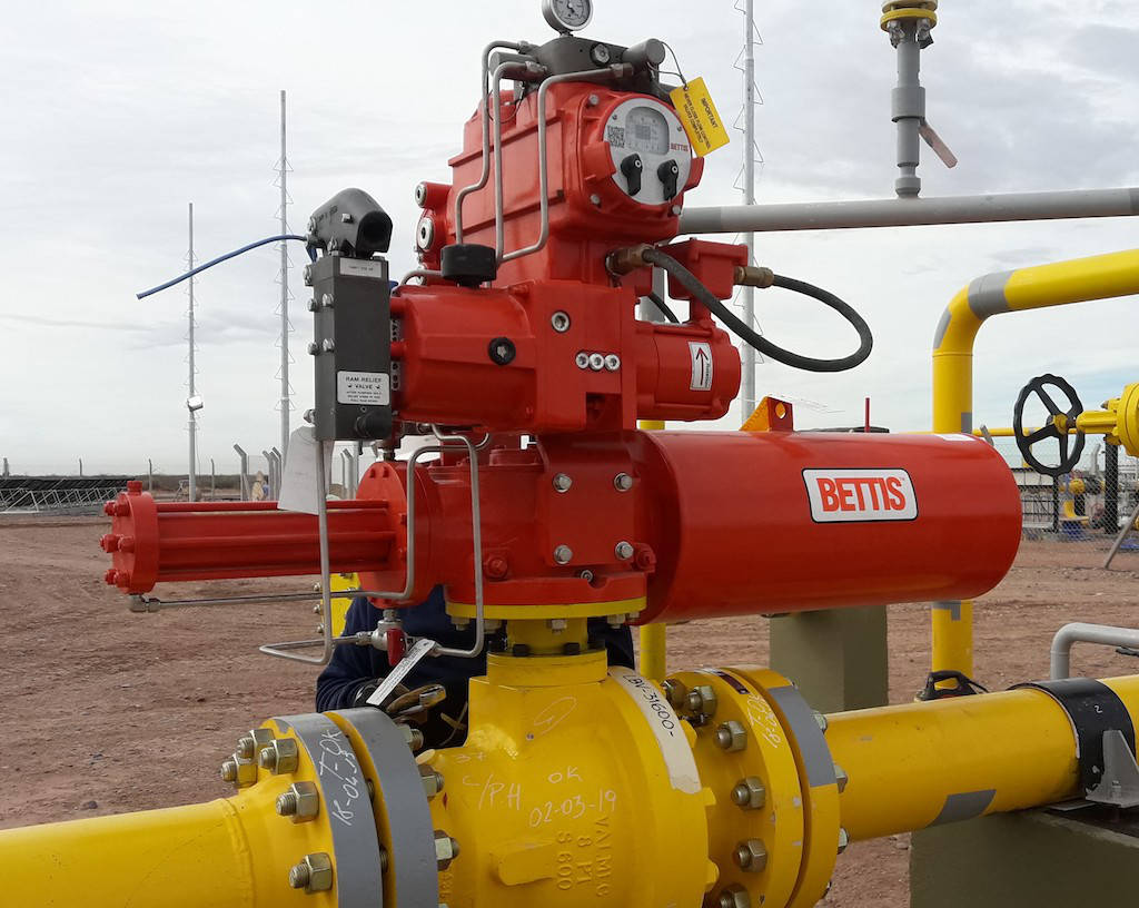

Compressor stations often employ automated valves activated using pressurized natural gas, requiring improved actuator designs to eliminate emissions.

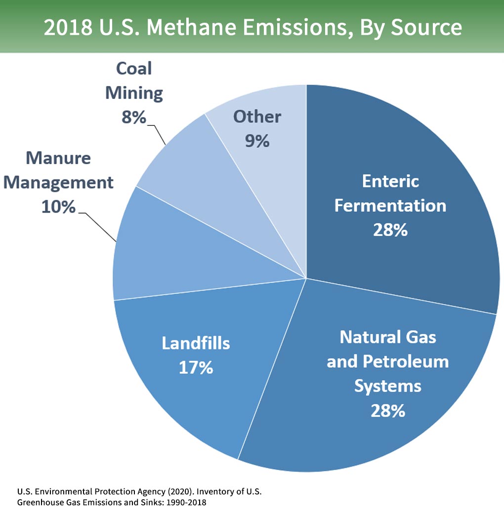

Natural gas emissions are a growing focus for government and industry. Methane, the major component of natural gas, is a potent greenhouse gas. Though carbon dioxide emissions in the United States were nine times higher than methane, methane inflicts eighty-four times more environmental damage in a typical ten-year period. In an effort to curb greenhouse gas emissions, governmental agencies around the world have passed regulations. Many of these rules target petroleum product production and transportation as these operations are a significant source of methane releases (see Figure 1).

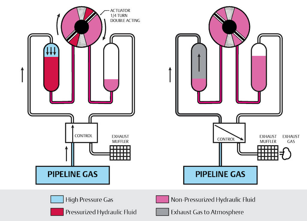

Gas motors use compressed pipeline gas to drive pneumatic motors that move the valve. While they have the benefit of requiring no electrical power, they emit significant amounts of methane. Gas-over-oil systems use natural gas from the pipeline to pressurize hydraulic oil, which is then used to drive rotary vane (RV) or scotch yoke (SY) valve actuators. After the valve has actuated, the gas pressure is released to the atmosphere (see Figure 3).
Gas-over-oil systems utilize the available motive force of pipeline gas pressure, yet also offer the inherent hydraulic benefits of small actuator size and long service life. While gas-over-oil systems have operated reliably for years, the resulting greenhouse gas emissions are driving the gas pipeline industry to consider other options.
