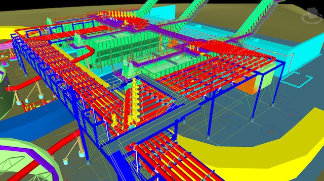

Figure 2: Solids removal/dewatering and wastewater recovery/recirculation system at a power plant greenfield project for a major U.S. energy producer. Courtesy: Salas O’Brien
