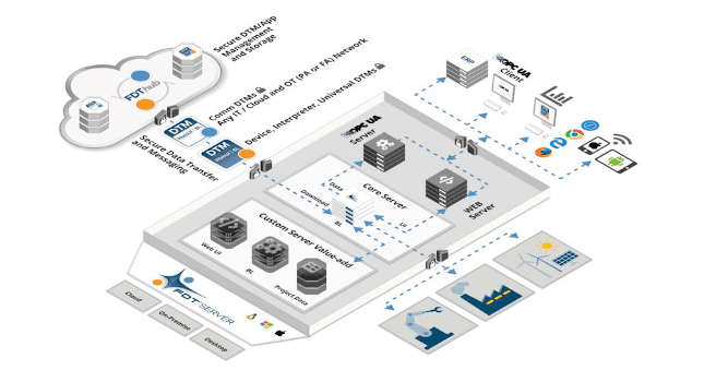

The FDT 3.0/OPC UA IIoT ecosystem, consisting of an FDT server and DTMs, delivers universal device integration and a data-centric platform to mobilize the industrial workforce with modern and diverse deployment options, including cloud, enterprise, edge, on premise, and single-user desktop environments.
Within the FITS architecture, the platform-independent FDT server serves as the pivotal Industrial Internet of Things (IIoT) hub empowering the intelligent enterprise. It is built on top of application business logic that manages all device DTM instances. The FDT server includes a web services portal allowing access from authenticated mobile devices or any major browser, along with an OPC UA interface for information technology/operational technology (IT/OT) convergence and enterprise access in the process, hybrid and discrete automation sectors.
A key feature of the FDT 3.0 standard is that all FDT servers and DTMs automatically provide full OPC UA support without additional effort or coding. This means any authorized OPC UA client can browse the project structure in the FDT server to locate device-specific, real-time information. There is easy integration of live plant floor data into apps, dashboards and manufacturing execution systems without the need to touch the DCS or PLC configuration.
Users have access to this information through a built-in and fully “wired” OPC UA server within the FDT server common components developer toolkit. The same holds true for DTM common components, as OPC UA is auto-enabled for DTMs. No additional coding or work is needed in either case.
As part of the FDT 3.0 solution, standard integration of information provided by DTMs into the FDT/OPC UA Information Model optimizes advanced device diagnostics, configuration and remote asset management. This information model enhances the management of networks and devices, helping to optimize the enterprise by giving access to data without the need for protocol-specific handling, providing support for a wide range of devices.
