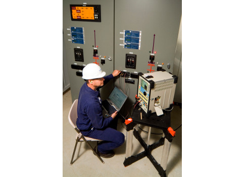

The ongoing maintenance issues of utilities and industrial facilities can influence the design of an IED application, and self-testing features can be used to alleviate some of the challenges. A traditional system with multiple electromechanical switchboard components requires diligent calibration, maintenance, and repair to keep it functioning.
When discrete components are eliminated and their functions programmed into an IED, there are fewer components to test and maintain. In addition, IEDs can perform many inspection and testing procedures automatically while the system is operating, reducing the need for manual testing and prolonged downtime, if they have been programmed properly.
What could potentially be a multi-week process that involves pulling out old relays; setting up a voltage and current injection relay test set; performing the testing; and calibrating, cleaning, and replacing each individual device is now much simpler.
With IEDs, the process is reduced to automated verification that the relays are correctly measuring the inputs through comparative analysis with other IEDs, and tracking and documenting all outputs at the time of operation. The time to complete testing may be reduced to days, if not eliminated altogether through real-time documentation—significantly reducing overall maintenance costs.
Maintenance capabilities programmed into IEDs can include monitoring, testing, calibration, and verification. A skilled integration engineer can program the IEDs to automatically report the status of all connected inputs, outputs, instrument transformers, transducers, equipment duty cycle/wear, and communications.
