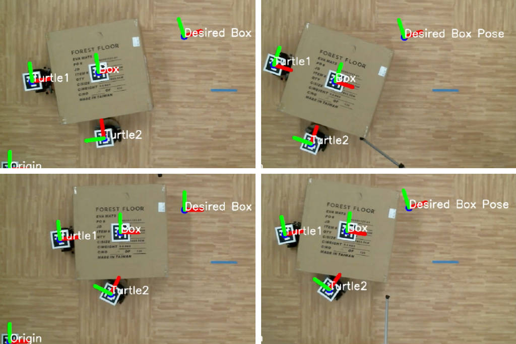

A new general-purpose optimization tool can improve the performance of many autonomous robotic systems. Shown here is a hardware demonstration in which the tool automatically optimizes the performance of two robots working together to move a heavy box. Courtesy: Massachusetts Institute of Technology

The first system comprised a wheeled robot tasked with planning a path between two obstacles, based on signals that it received from two beacons placed at separate locations. The team sought to find the optimal placement of the beacons that would yield a clear path between the obstacles.
They found the new optimizer quickly worked back through the robot’s simulation and identified the best placement of the beacons within five minutes, compared to 15 minutes for conventional methods.
The second system was more complex, comprising two wheeled robots working together to push a box toward a target position. A simulation of this system included many more subsystems and parameters. Nevertheless, the team’s tool efficiently identified the steps needed for the robots to accomplish their goal, in an optimization process that was 20 times faster than conventional approaches.
