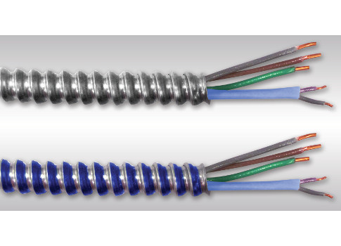

MC Luminary Cables are used for LED and fluorescent dimming, reducing procurement time on projects.
MC Luminary cables combine electric lighting and control circuits under a single interlocked armor. It can be used for fluorescent dimming. The cable features two or three single copper THHN conductors, one single THHN insulated ground, and a twisted jacketed pair of TFN conductors. The MC Tuff Luminary cable is the lightweight galvanized steel interlocked armor cable and the MC-Lite Luminary cable is the interlocked aluminum armor cable. Both are offered in 120/208 or 277/480 conductor designs with a TFN conductor low voltage control assembly under one armor. These cables are designed to reduce procurement time, shipments, installation time, and waste on the project.
