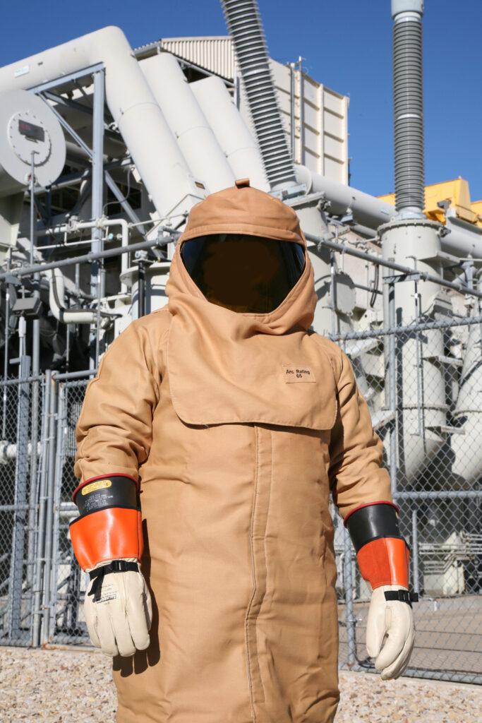

Figure 1: Arc-rated clothing and rubber insulating gloves. Courtesy: Shermco Industries

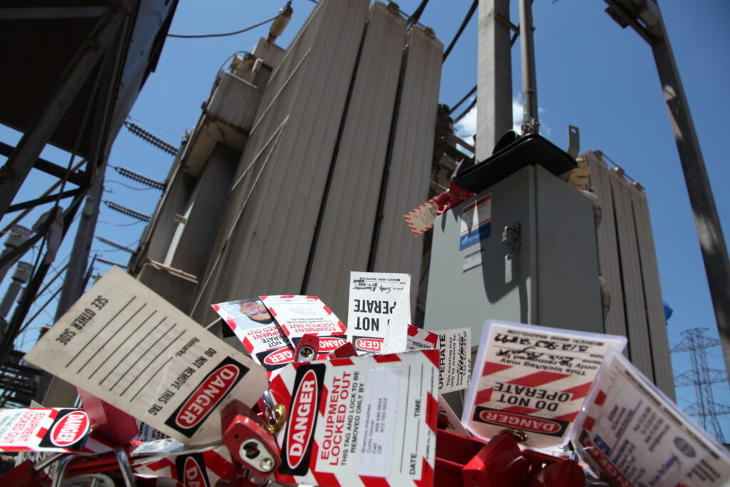

Figure 2: Locks and tags applied during a maintenance outage. Courtesy: Shermco Industries

4. Lock it out/tag it out (LOTo)
This is part of establishing an electrically safe work condition, but it is such an important rule to follow every time you work on a piece of equipment.
Locking equipment or power sources in the off position is to prevent unintentional energization. It seems like a simple and reasonable thing to do, but it happens all the time.  A worker doesn’t lock out a piece of equipment and gets hurt or killed.
The section 120.5 Lockout/Tagout Procedures is an excellent piece under Article 120. If you treat this section as a training and education guide for your personal use and understand it completely, not only will you be a safer worker, but you’ll also resonate as a leader to those around you. Treat it as energized until you know it’s not. Lock it out/tag it out.

7. Personal protective equipment (PPE) is a must
When it comes to your last line of defense — personal protective equipment (PPE) — you must read, understand and review 130.7 Personal and Other Protective Equipment. Within this section, you’ll find specifics for selecting and using appropriate PPE, including arc-rated clothing, face shields, gloves and other protective gear. It’s a very informative part of the standard — so know it well.
