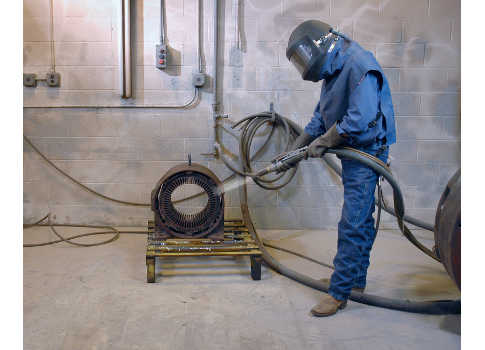

Cleaning and inspection: The General section recommends cleaning and inspecting all windings and parts, but avoids delving into the wide variety of cleaning methods (see Figure 2). Although this recommendation seems obvious, the document would be remiss without it.
