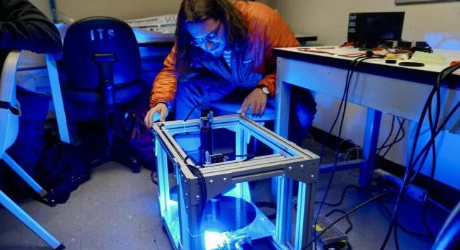

The Department of Mechanical Engineering seniors have built a silicon wafer center-finding improvement device for KLA, a semiconductor manufacturing company. The Senior Design team’s prototype uses two cameras to capture the circular wafer’s edge, plus computer software to calculate the radius and find the wafer’s center.
“The reason this is important is that KLA has to inspect these wafers for defects, and when they find one, they need to know where on the wafer it is with a high-level of precision,” said Marty LaRocque, the team’s electro-mechanical engineer. “They have to establish a coordinate system on the wafer and the hardest part of that is finding the center.”
Currently, KLA is detecting the wafer’s center with ten different images around the edge. The team of students designed their device to find the center just as efficiently with only two images.
“On one of KLA’s inspection tools, it currently takes them eight seconds to align one wafer, and we’re trying to get that down to two seconds,” said Project Manager Jack Carver. “A 75% reduction is going to get so much more throughput. With the global silicon wafer supply shortage, any improvements in that would be greatly beneficial for them.”
