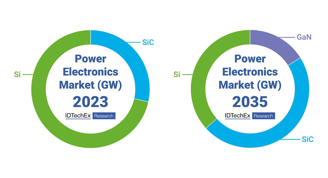

As battery capacity increases, so does the overall energy savings achieved through the use of SiC MOSFETs. Originally, SiC MOSFETs and larger batteries were reserved for mid to high-value EVs with larger batteries. With new mainstream and budget vehicles such as the MG MG4, BYD Dolphin, and Volvo EX30 having battery capacities greater than 50kWh, SiC MOSFETs are ready to penetrate Europe and China’s mainstream passenger vehicle sectors. This accompanies the head start gained from the US, with Tesla being the first major OEM to use SiC MOSFETs in its Model 3. IDTechEx’s report, “Power Electronics for Electric Vehicles 2025-2035: Technologies, Markets, and Forecasts”, predicts that the demand for SiC MOSFETs will increase 10-fold between 2023 and 2035, driven by greater efficiency and adoption of higher voltage platforms, with applications in inverters, onboard chargers, dc-dc converters.

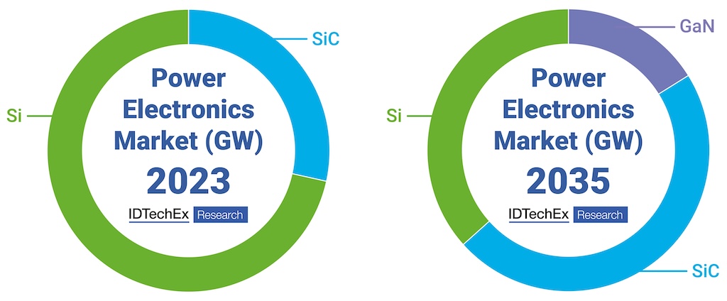

IDTechEx predicts the market share for SiC MOSFETs to be well over 50% by 2035, accompanying significant growth in the automotive power semiconductor market. SiC MOSFETs offer a solution to many narratives swirling around the EV market: range anxiety, fast charging, sustainability, and the rise of 800V architectures.
However, GaN will enter the EV power electronics market over the next 5 years. This market entry will vary by component: earlier for the onboard charger, dc-dc converter, and later for the traction inverter. Although GaN isn’t there yet, developments in substrate technology, vertical devices, and multi-level topologies will be accompanied by investments from large players in the automotive power semiconductor space. This will soon make GaN a realistic and widespread solution for EV power electronics. Over the next decade, one can expect the coexistence of Si, SiC and GaN in the EV power electronics ecosystem. IDTechEx’s new report on the topic, “Power Electronics for Electric Vehicles 2025-2035: Technologies, Markets, and Forecasts,” provides insights into these technologies and applications, identifying the potential market opportunities.
