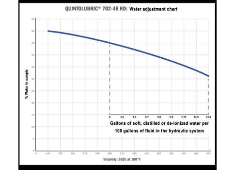

The viscosity of a water glycol fluid is directly related to the water content. The glycol and PAG thickener contained in an HFC fluid are not volatile and will remain in the hydraulic reservoir regardless of fluid temperature. As such, one would expect to see the viscosity of the fluid increase over time as water evaporates. The rate of viscosity increase will depend on such factors as ambient temperature, reservoir temperature, air flow across the reservoir breather, amount of make-up fluid added, etc.
A knowledgeable hydraulic fluid supplier can supply their HFC users a graph that directly relates the viscosity to the water content. Having such a graph eliminates the need to run actual water contents and allows for easy maintenance. It should be pointed out that a falling viscosity is related to excess water in the water glycol fluid. This excess water can only come from a leaking heat exchanger or over-addition of water in a water adjustment. Quaker’s suggested viscosity ranges are:
  • Normal operating viscosity range: 180 to 250 SUS
  • Viscosity below 180 SUS: Check for source of excess water.
  • Viscosity 250 to 500 SUS: Adjust with soft, distilled or deionized water according to charts.
  • Viscosity above 500 SUS or below 160 SUS: discard fluid and refill system with fresh water glycol fluid.
Should a water adjustment ever be necessary, adjustments will need to be made using soft, distilled or deionized water. Divalent metal ions, such as calcium and magnesium found in tap and spring water, will cause the lubrication additive in the fluid to become solid and ineffective.
