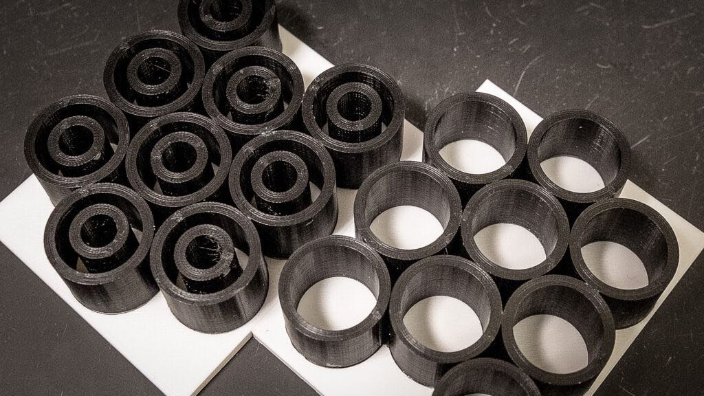

To achieve this breakthrough, the researchers tailored the design of their vertically aligned carbon nanotube foam to have unique structural features across multiple length scales. Their material has a novel architecture that consists of closely packed thin concentric cylinder structures at the micrometer scale, with each cylinder made of many carbon nanotubes, which themselves have a concentric cylindrical structure in the nanometer scale. These structures give the material its outstanding properties.
These displays show, at a much larger scale, the researchers’ architectures for their vertically aligned carbon nanotube foam. The display on the left depicts the architecture of closely packed thin concentric cylinder structures detailed in the ACS Nano paper. Courtesy: Joel Hallberg, UW-Madison
In this study, the team investigated a variety of design parameters and discovered the internal gap between the concentric cylinders plays a key role in determining the material’s overall properties. They varied the material’s density by changing the internal gap, and then observed how those changes induced different types of deformation in the material when compressed. Ultimately, the researchers discovered that increasing the internal gap, up to a certain point, led to better structural stiffness at low densities.
“In this work, we achieved a desirable linear scaling between properties and density in vertically aligned carbon nanotube foams designed with our unique architecture,” Thevamaran said. “We were able to create that linear scaling by tailoring the gap between the concentric cylinder rings. This allowed us to simultaneously improve our material’s damping capacity and energy absorption efficiency while also allowing the material to be extremely lightweight.”
