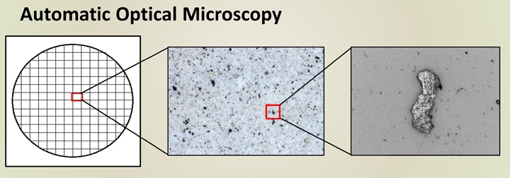

  5. Automated optical. This uses a computer-controlled microscope that can observe particulate captured on a filter like the gravimetric media and discriminate particulate types in order to focus on certain particulate such as wear debris only, not external contaminants, etc. Data is provided with much statistical support, classification of particulate in ISO codes and dimension of the 10 largest particles. See Figure 3.
