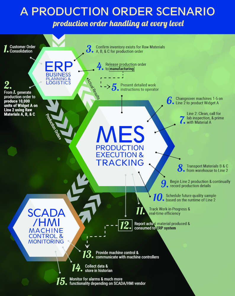

Manufacturers have many crucial systems that need to talk with one another. The traditional manufacturing stack includes human-machine interfaces (HMIs), supervisory controls and data acquisition (SCADA) systems, manufacturing execution systems (MES) and ERP layers. These systems are most effective when they work together.
For example, in an integrated manufacturing stack, an ERP system may confirm inventory exists and release a production order to manufacturing. From there, MES makes it possible to present detailed work instructions to the plant floor operator, schedule production, track real-time work in progress (WIP) inventory, and more. Once the production order is fulfilled, the actual material produced and consumed is reported back to the ERP system. SCADA/HMI provides machine control, communicating with machine controllers, collecting and storing data and monitoring for alarms. This fully integrated process simplifies the operator interface and reduces the complexity of operator tasks by presenting everything in one place.

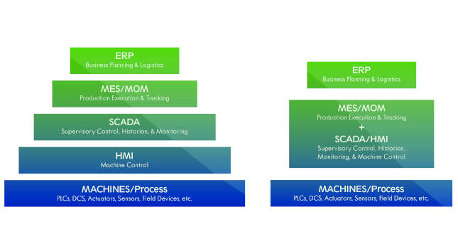

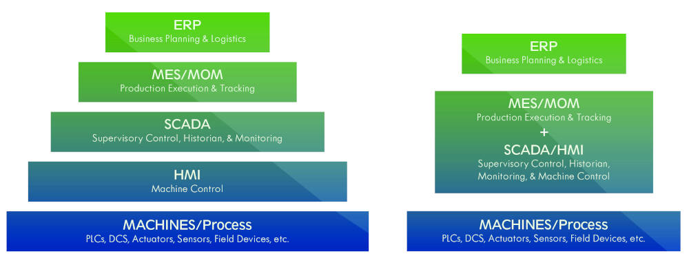

1. Reduced operator training:
By flattening the integration stack, machine operators need to complete only one workflow instead of two, resulting in less work and lower risk of forgotten data entry. Everything the operator must do is now presented on a unified human-machine interface (HMI), which eliminated the need for a second interface for inventory information entry.
Figure 2: Simplifying the MES system stacking can make communication simpler and easier. The Sepasoft business connector connectivity tool works with the SAP ERP module for native connection to SAP servers and uses the SAP remote function call (RFC) protocol without additional middleware. Courtesy: Grantek/Sepasoft
