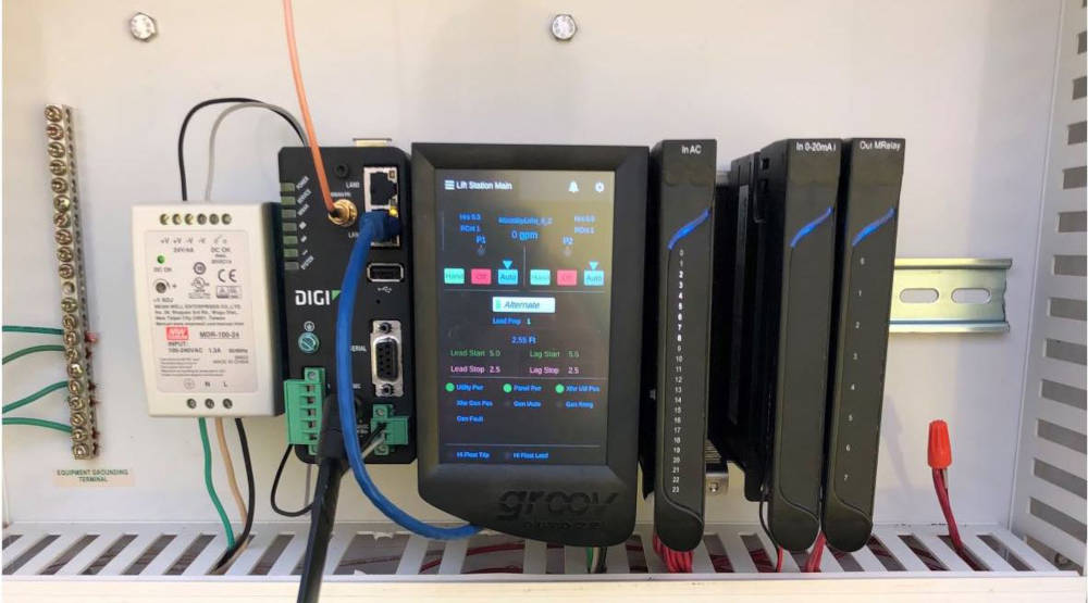

Building secure wastewater management in the cloud for IIoT
For years, Waterford Township has shared data among its water/wastewater core applications, including geographic information systems (GIS), asset management systems (AMS), enterprise content management (ECM), and supervisory control and data acquisition (SCADA). But long-standing systemic limitations had them looking for newer technology.
With over 90 controllers on its network, the polling mechanism combined with the limited bandwidth of the radio network meant site data updated only every 3-5 minutes. If a lift station ran briefly between polling cycles, reporting gaps and undetected issues caused problems. And each I/O point added to the system made the latency worse.
It seemed clear to Waterford that MQTT could be a solution, reducing bandwidth usage while making sure data is reported. Instead of cyclic polling, MQTT would follow a strict report-by-exception publishing rule. Field devices and other MQTT network clients would send data on their own, but only if a monitored value changes.
“We have many lift stations that will spend most of their time sitting,” said Russell Williams, director of public works. “Why transfer data all the time?”
To help them execute their IIoT implementation vision, Waterford DPW engaged Perceptive Controls, a Michigan-based system integrator. They chose an edge controller because of its built-in MQTT capabilities, familiar programming tools, and lifetime I/O warranty. After experimenting with SCADA packages, they decided on one with MQTT integration, including the ability to serve as an MQTT broker. Establishing communication was straightforward with the right tools.
“It kind of happens automagically,” said Kevin Finkler, software engineer at Perceptive. “You basically define a few parameters [in Ignition] to set up the broker.”
The controller’s MQTT infrastructure has reduced field updates from multi-minute cycles to sub-second event-driven publications. With that kind of speed, Waterford never misses a system action or alarm notification. And with analog I/O deadbanding in each EPIC, they’ve also reduced bandwidth consumption, allowing Waterford to publish additional data that wasn’t possible before.
Waterford and Perceptive deployed the new system in the cloud on Amazon Web Services (AWS). Perceptive can update controllers over the air, reducing travel time and speeding project development.
For security, they configured the AWS firewall to accept traffic only from the new edge controllers and specific Ignition clients in Waterford’s and Perceptive’s offices. They installed a client SSL certificate on each controller, so the SCADA could authenticate and encrypt the connection. In addition, every authorized user must create strong passwords to access any edge controller or SCADA client in the system and every user login is tracked and reported. All this gave Waterford DPW the data they needed when they need it.
Figure 1: One of Waterford DPW’s lift station control panels, showing the new layout with the Opto 22 groov EPIC controller and DIGI modem. The water/wastewater utility chose the groov controller because of its built-in MQTT capabilities, familiar programming tools, and lifetime I/O warranty. Courtesy: Opto 22

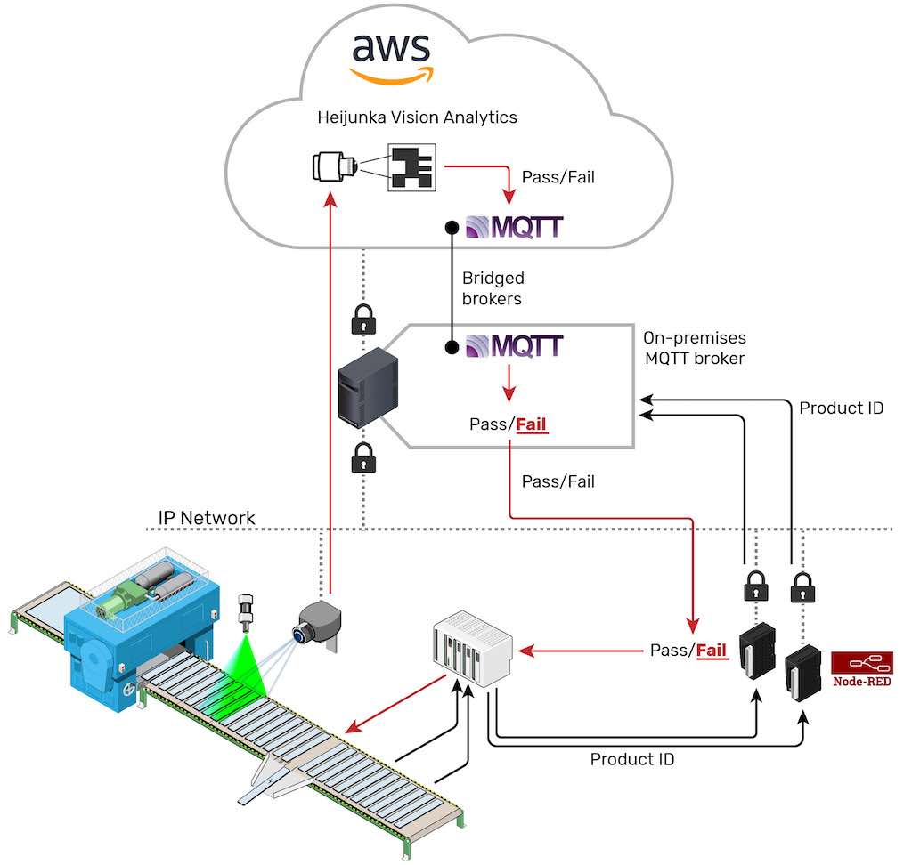

IIoT: AI-powered vision system connects manufacturing data to the cloud
California-based Intrinsics Imaging offers customers machine vision systems with machine vision software. Instead of programming specialized cameras to inspect manufactured goods for defects, the machine vision software works with any IP camera.
A recent customer wanted to integrate the machine vision software directly into process controls in two production lines moving discrete boards at high speed:
  • The primary line cuts large sheets of raw material to size. Cut sheets need to be inspected for excess moisture as well as dents, debris, and scratches as small as a grain of rice. Hundreds of product types go through this conveyor.
  • The second line monitors milling quality, looking for chipping along the edges.
The customer also wanted a pass/fail I/O signal that integrated directly into the programmable logic controllers (PLCs) that reject material. Bypassing the SCADA and going directly to PLC action would simplify integration and reduce latency.
Intrinsics CTO Eric Cheng said, “I wasn’t sure what kind of device could provide a physical interface to our cloud-based system and also satisfy our technical and operating requirements.”
Cheng said the machine vision system’s communication infrastructure is built on MQTT. “It’s usually new for customers, but it’s typically the best way to meet their performance and security requirements. [MQTT is] lightweight and low-latency… and it doesn’t require us to reach into their network from the outside.”
Figure 3: California-based Intrinsics Imaging offers customers machine vision systems with its Heijunka Vision software. Intrinsics’ hybrid architecture used MQTT communications and groov RIO modules on each production line to allow cloud-hosted analytics to securely control action in the physical process at the edge of the network. Courtesy: Opto 22
The I/O device Cheng needed would have to tolerate an industrial environment, integrate with the machine vision software’s existing software stack, and operate with minimal latency. Just five seconds were available for detection and rejection after a video capture was sent to the machine vision software.
The edge I/O had the industrial build Cheng needed, as well as a Linux core and multiple options for MQTT. Cheng also appreciated its web-based interface, Node-RED runtime, and embedded firewall – no need for a Microsoft Windows-based PC.
For security, Intrinsics built an isolated network at the customer’s facility to connect cameras and edge I/O modules to an on-premises MQTT broker. A separate network connects that broker to the internet for video streaming to the machine vision software and data exchange with a cloud MQTT broker, both running on Amazon Web Services (AWS). The two brokers are bridged to exchange data, so clients on both systems can use it.
Each edge I/O module makes an encrypted connection to the local broker, which has only port 8883 open for secure connections. The local broker acts as a firewall for the OT side of the system while still allowing data to be exchanged with the machine vision software in the cloud.
Production line PLCs encode the product ID for a specific part and send it through the controller, which uses Node-RED to publish the data as MQTT topics. The machine vision software decodes the product ID and sets the algorithms for that product, then publishes quality indicators to the MQTT broker in the IIoT implementation.
The edge I/O module subscribes to the quality data via Node-RED and indicates the pass/fail decision through one of its relay outputs. The production PLCs watch these outputs and trigger a physical rejection if needed.
The customer has been automatically rejecting defects for several months now, and the system provider confirms a round trip time, from measurement to result, of less than two seconds.
“We were under the gun to do this [project] quickly,” Cheng said, “but we got it figured out in less than a month… Now we can provide a direct physical interface to low-level automation systems.”
